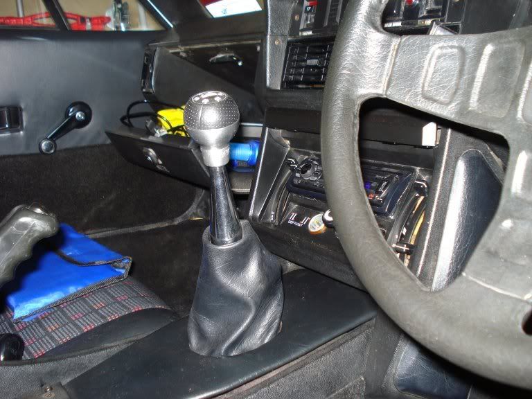

Or get yourself a ± 14mm alloy tube which you place over the gear stick and use the gear knob from a Mini ...
So if I properly understand Theo, you shortened the standard shifter, and slide the alloy tube over the stick then thread the new Mini knob on the old gear stick???
Postby Beans » 06 Feb 2009 09:42
Correct (b.t.w. it's an aftermarket gearknob from a (classic ) Mini)

Postby PeterTR7V8 » 06 Feb 2009 19:07
My shifter has a short shifter extension under the stick which makes it sit a couple of inches higher. I almost have to reach up to shift but the throw is only about 2.5" from odd to even gears so it feels nice & racy. [8D]
Odd, how did you get to have your console knobs above the stereo?

Postby Odd » 07 Feb 2009 05:37
<blockquote id="quote"><font size="1" face="Century Gothic, Verdana, Arial, Helvetica" id="quote">quote:<hr height="1" noshade id="quote"> Odd, how did you get to have your console knobs above the stereo? <hr height="1" noshade id="quote"></font id="quote"></blockquote id="quote"> By use of old sins/knowledge from a plastic-model building youth...[:I]
<blockquote id="quote"><font size="1" face="Century Gothic, Verdana, Arial, Helvetica" id="quote">quote:<hr height="1" noshade id="quote"> Odd, very nice! I especially like the shortened gearbox extension. Did you do all the work yourself? <hr height="1" noshade id="quote"></font id="quote"></blockquote id="quote"> I did it all, except the actual alloy welding. That I outsourced to a true alloy welding vizard...

Postby jclay (RIP 2018) » 07 Feb 2009 22:21
<b>Shifter Housing:</b>
I am editing an article written by Odd about the shifter housing modification with bigger photos. It will be up on the Technical Site soon.
