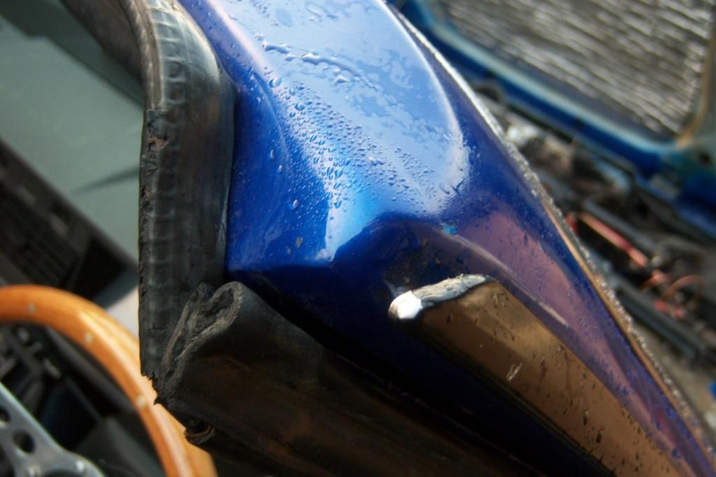

Despite a new hood water is still dripping on the seats.After looking at some other DHC's there seems to be something they have and that mine does not,is there in fact something missing(Not the ridiculously expensive plastic doorseal finishers)

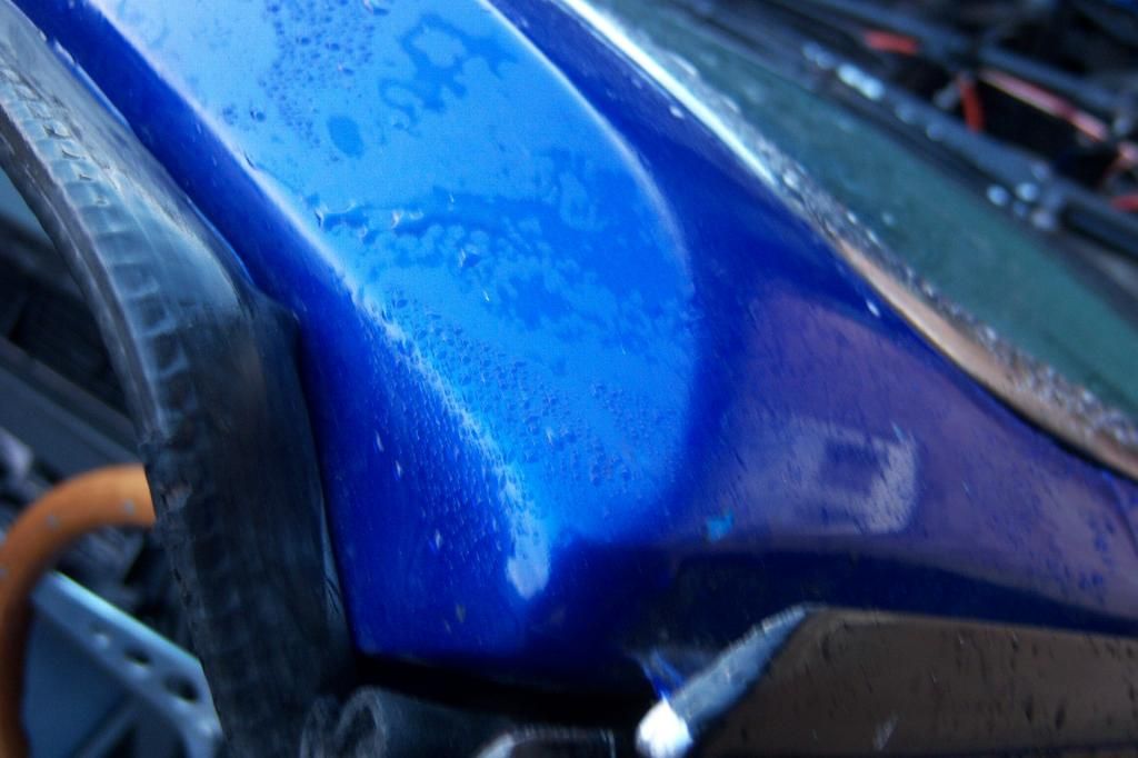

Postby Beans » 10 Nov 2014 19:02
A few parts missing there, seal XKC3848 and finisher YKC3376/7
Although the latter shouldn't be that much of a problem. And yes these door seals were replaced for slightly longer ones ...
Also look how the hood sits against the front screen surround

Postby sonscar » 10 Nov 2014 20:34
Thanks for the photo that is indeed the missing part.The hood seal is intact and the leak is only at the corners but unfortunately due to the curve of the screen it falls directly on the front of the cloth section of the seat,I will have to order some.Do they glue onto the screen pillar?.Thanks Steve..

Postby Beans » 11 Nov 2014 14:58
<blockquote id="quote"><font size="1" face="Century Gothic, Verdana, Arial, Helvetica" id="quote">quote:<hr height="1" noshade id="quote"><i>Originally posted by sonscar</i>
... Do they glue onto the screen pillar? ... <hr height="1" noshade id="quote"></font id="quote"></blockquote id="quote">
Correct. And as a result easily damaged when removing them.
