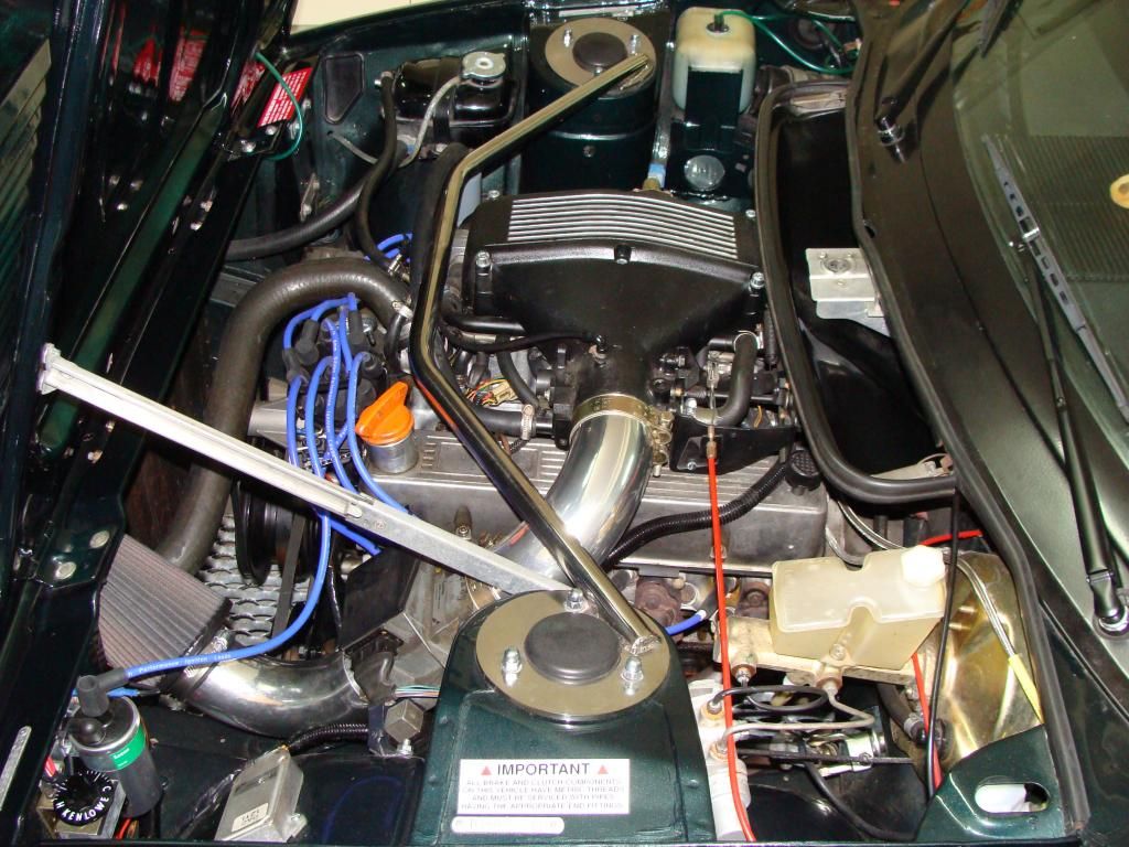

Postby Triumph TR7V8 coupé » 15 Feb 2015 17:27
Never had any problems with it but it's a close fit
and indeed there's a small opening to pass the bonnet release cable, at least on mine...
Cheers, J.
