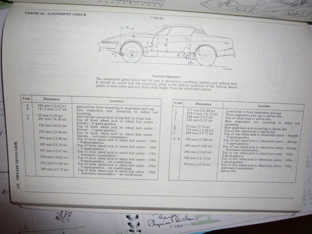

Does anyone have access to the chassis info for an AutoRobot jig?
My car finally made it onto the chassis puller today but the shop doesn't have the numbers & neither do the AutoRobot agents. Their plan is to do a left to right comparison which is better than throwing their hands up in defeat but the numbers would be better.
Cheers.
Postby tr8 » 09 Apr 2009 02:23

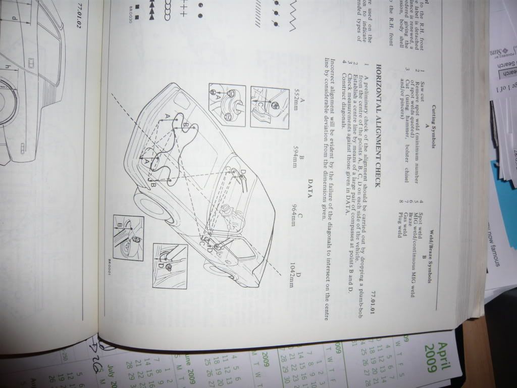

Is that what you need?
Postby tr8 » 09 Apr 2009 02:28
In trying to decifer the first image, I think the dimensions that they give as A, B, C, D, really should read A-A, B-B, C-C, D-D, or the length of the line between the same lettered points.
Maybe intuitive to some, but I had to scratch my head...
Postby PeterTR7V8 » 09 Apr 2009 03:16
Thank you Paul. I've passed that onto the guys in the overalls who will know what to do with the measurements.
