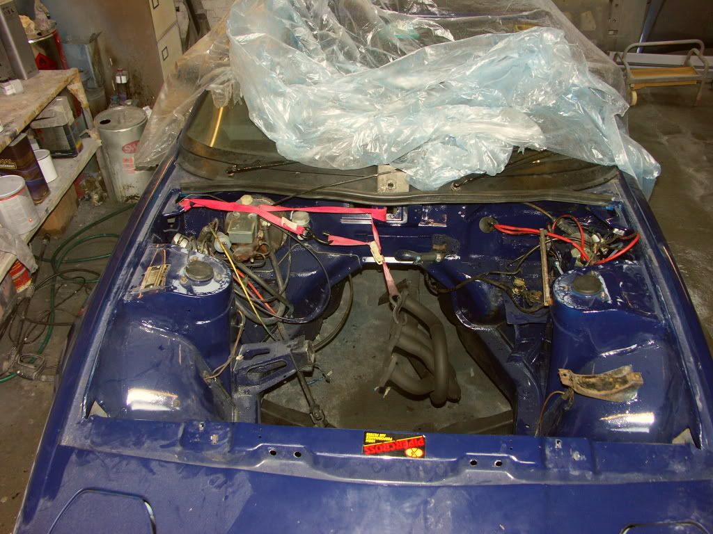

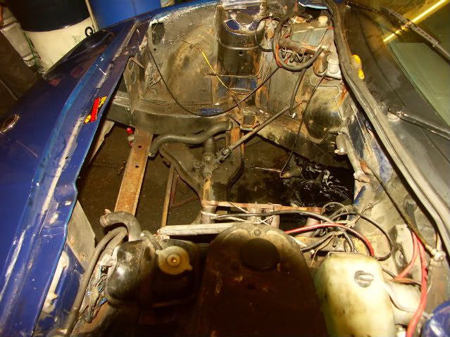

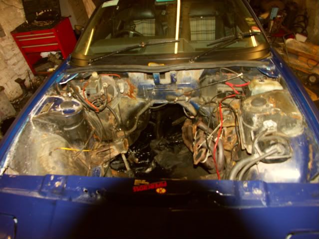

Postby gaz » 29 Oct 2008 12:24
well here we are again, i once posted a couple of threads titled "engouragment needed" well i don't think its encouragement needed i think its a "shrink needed" this time
pics of work been done
well the engine bay at least..........

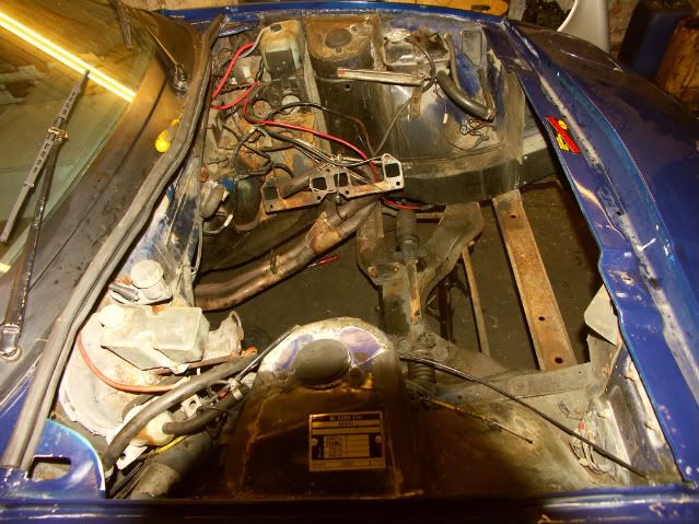

this one i posted it a couple of weeks ago on another thread but i'll put it in this one to compare..........
as we can see pretty standard apart from the carbs and tubular manifold and sports exhaust..........and as it is at the moment i'll post some more piccis as it progresses............
Now i wouldn't say i am going to go to town on this but i was thinking
about painting the tubular manifold with the heatproof paint or using wraps although i am a bit concerned about using wraps on the exhaust because of there placment in the engine bay ie. directly underneath the grills on the bonnet and the fact they will wet more often than they are dry so im thinking rusty crusty pipes what are your thoughts guys

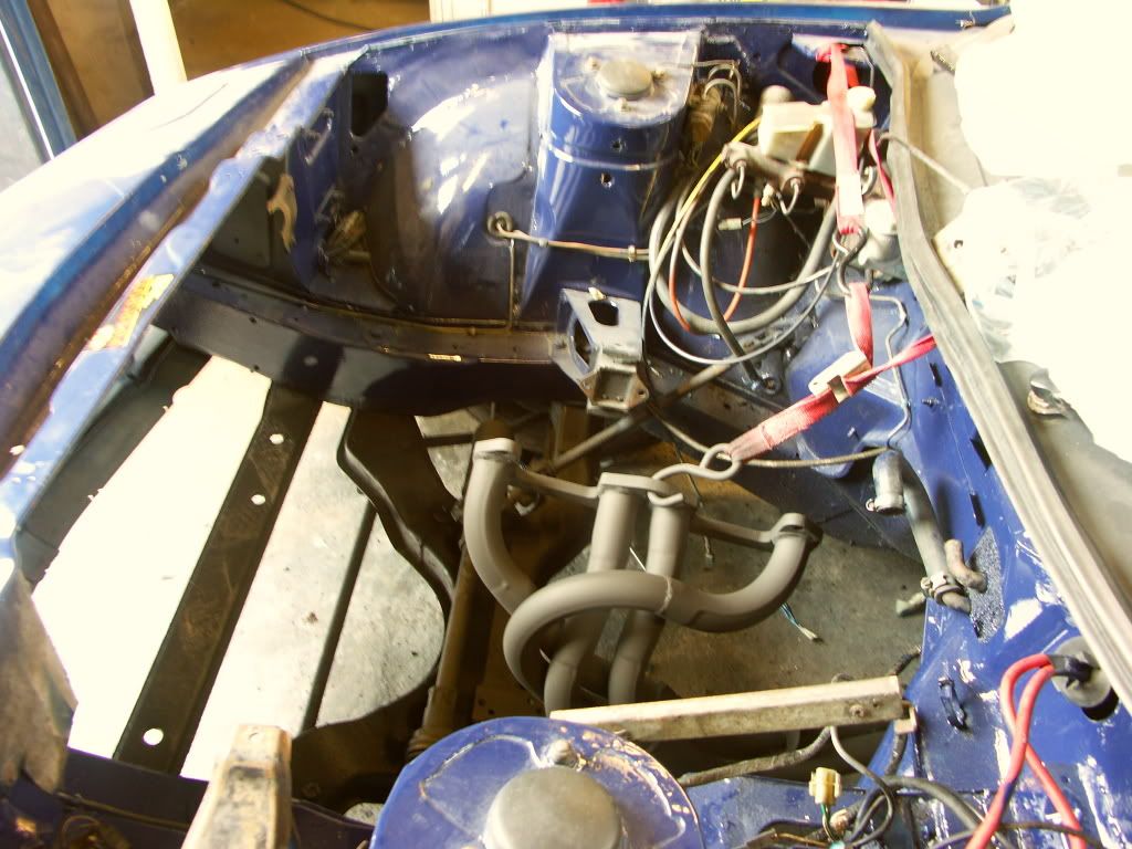

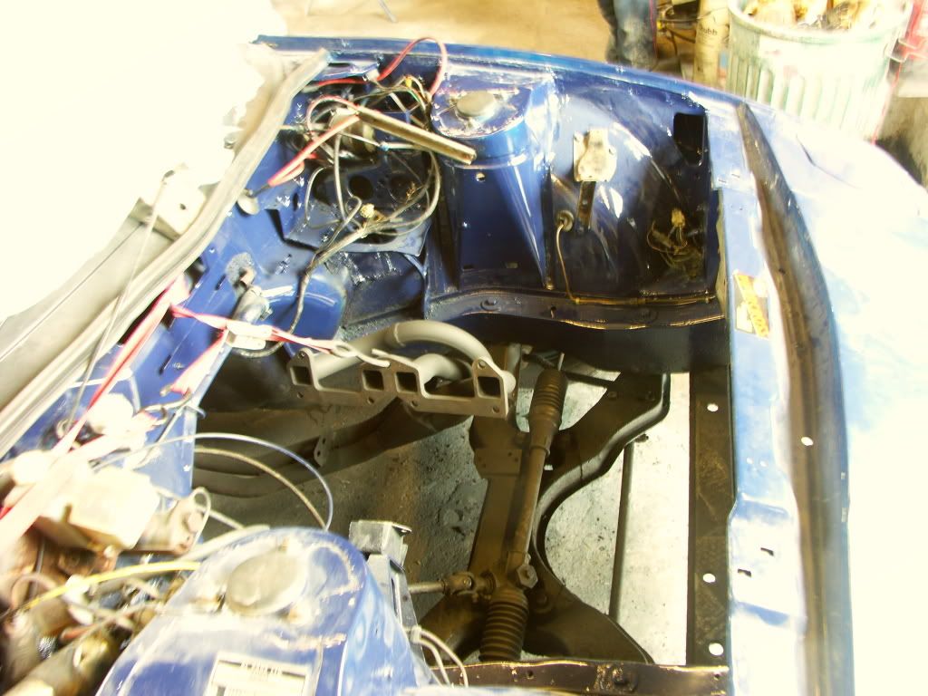

Postby gaz » 16 Nov 2008 08:57
well i got my my manifold painted high temp paint looks pretty good and the engine bay well it wont win any top prizes but its a dam site better than it was the other week..........
Postby gaz » 16 Nov 2008 16:55
and a couple more:
