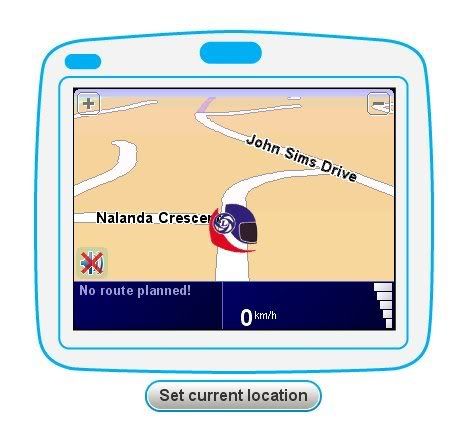

I have done a BL Helmet. Not too difficult but for an actual TR7 pic you want a picture of the car will give the impression you are following the car in a helicopter - ie, from above & behind. This is so it fits with the 3D perspective. You need a 24 bit 80x80 pixel BMP image with a red background (the red is transparent). Then connect the TomTom to the computer & copy the picture to the Art/Cars folder on the TomTom.
BTW it only works with 3D view. With 2D view you can only have the default blue arrow.
