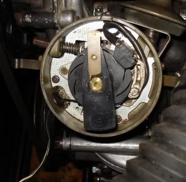

I just got a XR700 electronic unit and a Lucas Distributer 47DE4
it did not come with a coil.
Ted Schumacher tells me I need the standard or compatible coil and what ever else it is connected to the coil???????
The unit came out of a 1980 TR7 .

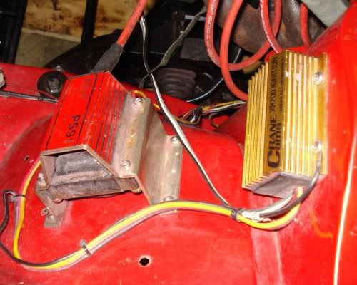

I am referring to the after market ignition crane xr700
Peter just sent me an e-mail informing me that he has the same xr700
and his coil is a Crane PS91.
So my question now is :
can i use this ps91 and that's all or do i need something else???
Been that i have the new lucas distributer 47DE4.
I just want the car to live again
Postby PeterTR7V8 » 09 Jul 2009 23:07
Zekow, I have the XR700, the PS91 & nothing else. The distributor is a 36D8 with optical points.
