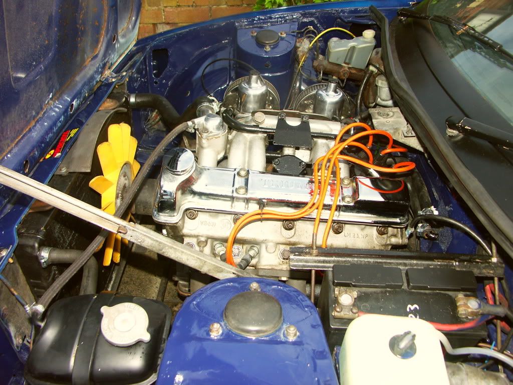

engine bay gets de - shultzed and painted
Postby gaz » 21 Nov 2008 18:37
not the best photo but looks sweet..........
Postby PeterTR7V8 » 21 Nov 2008 20:05
It does look sweet & I like the way you've found to recycle some old cam belts. Innovation in the garage is what separates us from women [:D]

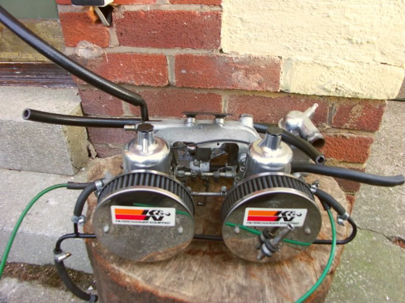

i brought the carbs and inlet manifold back with me the other for a bit of spit 'N' polish and boy did they come up well i tried engine de-greaser, carb cleaner and allsorts on the manifold but the stuff that worked best was wd40 wire wool and a wire brush oh, and a dremmel for those hard to reach corners.......
the dash pots and thermostat housing were polished by a local firm who my brother deals with they cost me £10 hardly worth polishing my self for that sort of money........
but what i was suprised at was the amout of crud in the bottom 't'shaped pipe the one with the olive and nut that fastens onto the union at the bottom of the inlet manifold couldn't get get that cleared " worse than the old wax in my ears " " hey what did you say " " i heard that pardon "............
S&S have stainless steel replacments so with a brand new one ordered should be a while till it ends up in the same state....
i wouldn't mind i have a spare set of inlet manifold & carbs and the bottom pipe was actually in a worse state than mine makes me wonder how many of us have the same problem unknown to ourselves i presume it pretty common..........

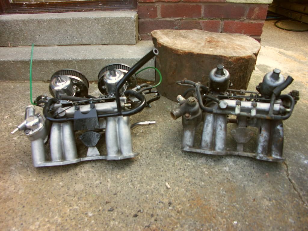

anyway here's a piccy:
Postby gaz » 07 Mar 2009 07:14
thougt i would post a couple of piccies for commparison to escape any confusion the one with the pancakes is going on the car a little elbow grease is all you need
the second set i bought for spares of fleebay very very cheap and came with the pancakes
stainless water pipe.....located underneath the manifold..
now this suprised me cos the spares set was in the same state as mine......blocked on that little "u" bend and nothing on either pipe could be shifted i used hot water paintstipper wd40 even a couple of interwound paperclips in a drill and also a dremmil
then i found that repalcment are cheap and won't rust
as said before i wonder how many of us have or are driving around with a small blockage..............

Postby gaz » 09 May 2009 20:29
just finish the thread:
cliff
Posts: 184
Joined: 23 Nov 2006 06:08
Postby cliff » 09 May 2009 21:21
BBlliinggggg!!!!! Very nice, by the way what is the tag on top of the rh turret??[?]
Cliff[8D]
Don't use force, get a bigger hammer!!
Postby gaz » 09 May 2009 21:56
right hand turret ??? servo side or battery side depends on where your stood, battery side no tag just a rather crude welded patch painted, servo side vin plate
Postby saabfast » 09 May 2009 22:24
Or do you mean the earth/ground tag on the (UK) offside turret? I assume they all have one as mine has.

Love the new engine bay.I have always fancied a 'pimped' painted bay.I like the red bull can thing too YOINK I am stealing that idea[:D]

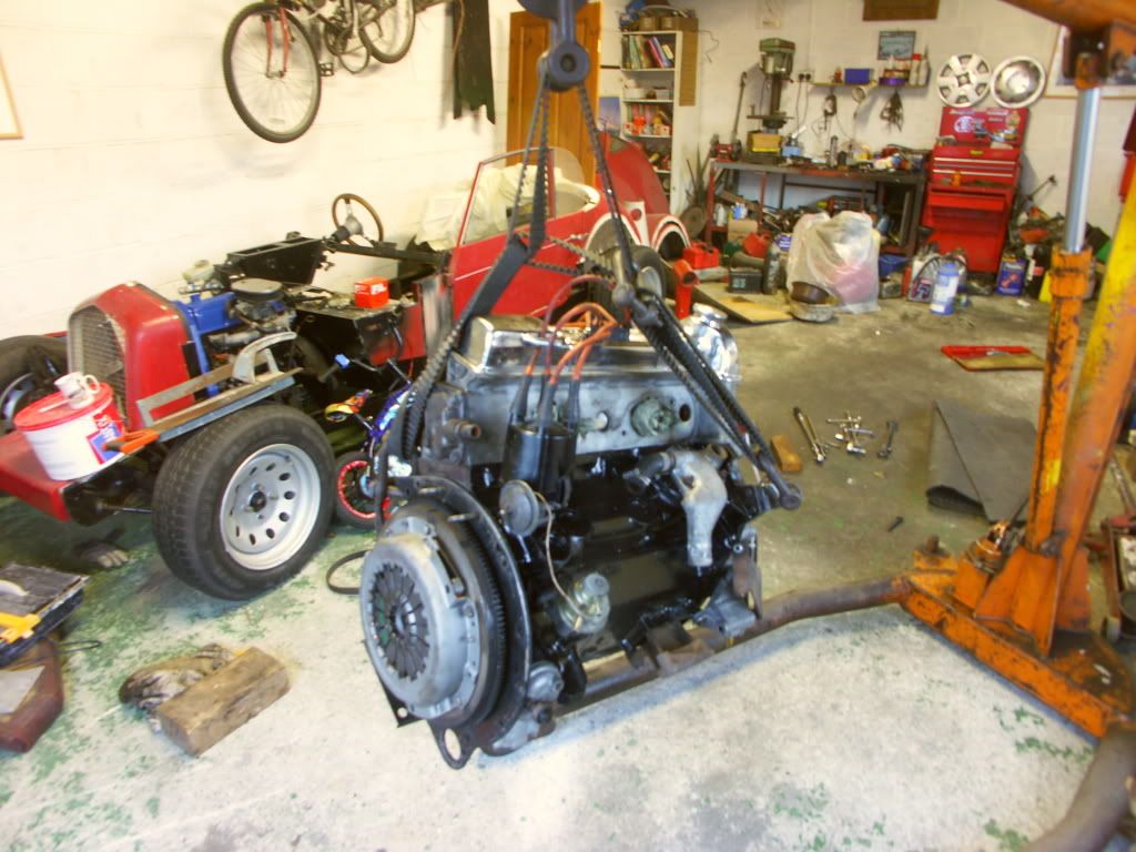

Gaz.....Id like to ask, did you install the engine and trans as a whole? Or did you run up the trans from underneith and the engine after?
Im getting ready to install an engine in my TR7, and I pulled the old engine out and left the trans in place. Im just wondering how difficult it will be to reinstall the engine w/the trans still in place, or should I drop the trans out and install both bolted together?
(Ive done a few TR8's while leaving the trans in place, but this is my first TR7 engine replacement)
