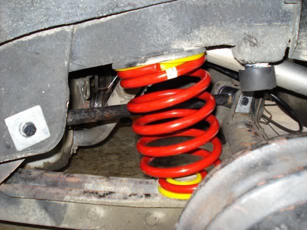

Postby PeterTR7V8 » 12 Nov 2009 22:46
Thanks J. Appreciate the info. I've just had the car out for a wheel balance & it is feeling much better - no clunk. I thought I had already posted this photo but in any case it shows the new washers on the upper arms. Big enough I should think.
