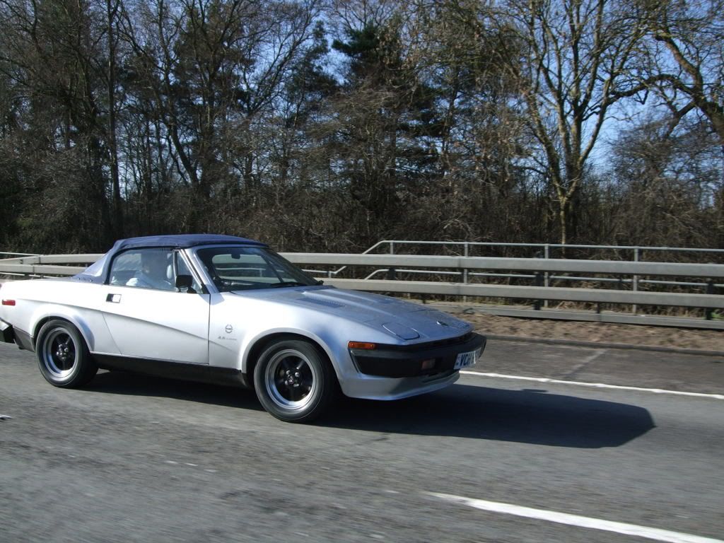

Postby john 215 » 01 Apr 2009 21:48
Hi Mark.
Ran 17 inch's on mine last year, didnt need to run spacers for wheel arch clearance but because the wheel hob rubbed on my SD1 based disc kit (Rimmer Bros kit [V])
The actual wheels were Avez Type A and came of an MGF and cost me NOTHING [:D] as were going spare where i worked an MGF Tech. They are 17 by 7 1/2 J and have 205/40 tyres fitted. The rear ones would just catch the arch if a very large bump was hit. Not sure of the offset can have a look or measure them at some point, they are sitting in the garage at the moment. Personaly gave a very stiff ride, must be getting old!!
Went back to 14 inch revolution now, personal thing just prefer the look!

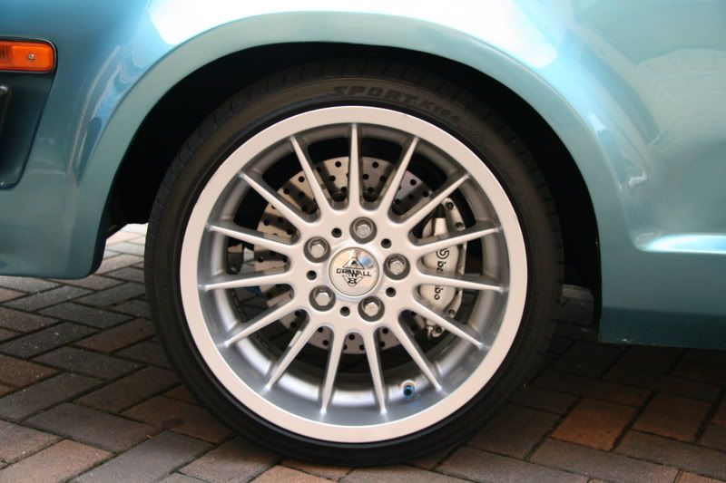

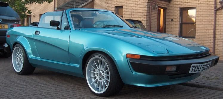

scottish grinnall
Posts: 333
Joined: 12 Nov 2005 00:48
Postby scottish grinnall » 02 Apr 2009 17:49
I have 17" on the Grinnall[;)]
Plenty room for BIG BRAKES
Image Image Image
Ianftr8
Posts: 900
Joined: 12 Dec 2007 17:09
Postby Ianftr8 » 02 Apr 2009 18:20
Now thats one superb looking car - those wheels really do add something special too.
Well done.

Postby PeterTR7V8 » 02 Apr 2009 20:51
Them modern wheels really demand the modern colours on a body kit to compliment them on our cars & I doubt whether there is a better example than Scottish's car. If I owned that car I'd have to upgrade my garage & have it lined in Italian marble.

Postby john 215 » 03 Apr 2009 20:33
Hi Adam,
Just got a new set of 195/60 14 Yokohamas for £160 for all 4 [:D] so hopefully right foot allowing will last a little while. The circuference is about the same between the 17 and 14's just always liked Revolution wheels!
Pictures courtsey of Ian TR8 [:)][:D][8D]
