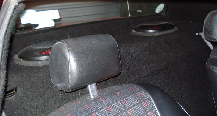

Mine is flocked as described by Hasbeen but in my case it is filled with speakers. I've never seen another wedge in the country that is so flocked. It looks much better than the factory vinyl finish.

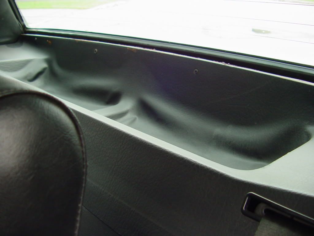

This is what my 1979 TR8 coupe rear shelf looked like before I repaired it. I cut and X in the bottom of the two pockets going corner to corner. Then glued the flaps down and any parts that had lifted. This left a big uncovered X in the bottom of the pockets and a bit up the sides of the pockets. Them I put some black automotive carpet glued into the bottom. I touched up the little slits up the corners with a black marker.
Not perfectly stock, but you have to look really close to notice that ii is not stock. Sorry no after pictures...car is in storage at the moment.

Mine looked about like that, but a little worse. Here's what I'm going to try...
I stripped all the black vinyl off the pressboard and found some very weak sections and some broken parts - corners, edges, etc.
I've glued the weakened/broken areas.
Using fiberglass matting, I'm going to re-enforce the corners and edges and I might even add a strip of either masonite or aluminum along the front edge (on the backside) as mine is wavy and uneven.
Sand and smooth everything, then spray it with a textured black paint.
If that doesn't turn out as well as I'd like, I will then either glue down a thin flock-like material or carpeting.
The thicker material I use, the more difficult it will be to form in the corners, but it will cover any imperfections better.
I'm even considering contructing some lids and making the storage areas enclosed.
I'll post some pictures when I'm done.

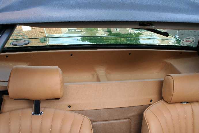

<font color="green">When I had the interior of GRD re-trimmed in leather the trimmer did the parcel shelf too. Made a nice job of it. Here's the shelf when I first got it back from the re-trim [:)]
Problem is that it has still been affected by the sun since then. Whatever glue they used seems to melt in the heat and the edges hace lifted. Have tried sticking it back down but not found anything which will last even with the sun of a UK summer on it [:(]
If anyone is interested there are more pictures of the re-trim in My Photos. Before anyone comments yes it was a mistake not to have the vertical board behind the seats done at the same time - isn't hindsight a wonderful thing? [;)]</font id="green">
