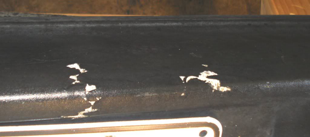

Meanwhile, I've ditched the wing & removed the exterior trim & bumpers which I plan to paint myself to save money. The front bumper needs a minor repair from when I drove into the workbench I built in the garage. What can I say, it wasn't there the day before. I was thinking some epoxy resin would fix this but would welcome other ideas.

The bumper can be plastic welded. Epoxy is NOT suitable, unless
you have an Oz aftermarket fiberglass bumper cover. Some
solvent based adhesives would work, but to find out what, would
require some experimenting, where it would not show, to test
adhesion
You need someone who does a range of stuff, so he knows about more
plastics than just dashboards, & motor bike fairings. Otherwise they
may try to use the wrong filler rod material. A quick chat should
tell you if a bloke knows his stuff, its not rocket science.
I had a rear corner of my 7 damaged by a truck, in the local service
station, 6 days after it went back on the road.
I was lucky to find a really knowledeable bloke, who welded it up, &
painted it, using a special primer.
That was over 6 years ago, & i've had no problems with it since.

The bumper does seem to be covered by a fibrous material with a thin plastic crust. It is only the plastic that is chipped.
