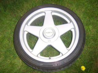

I have 205/40 17 on mine and they clear fine, not sure how much wider you could go [?]
