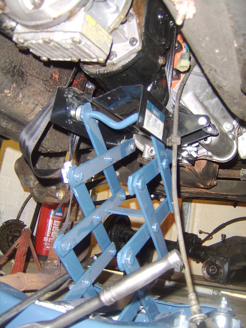

I dropped my transmission out the bottom (would be same with 4 speed) but I had combo jack stands and hydraulic jacks to get about 21" combined lift. Top of bell housing just cleared a natural notch in the side frame. I used a $40 ATV scissor jack on a piece of melamine with 6 rollers. I've not driven a 4 speed but reputedly they are smoother shifting, 1st isn't so bull low, not sure how they are at high way speeds relative to 5 speed (haven't looked at ratios). But if you already have a good LT77 and diff then it might not make sense rebuilding the 4. Some people have used the 4 speed diff to get more relaxed cruising than the 5 speed 3.9 diff, just need some mods to the drive shaft.

How much do you have to raise the car off the floor to remove the gearbox on its own? How easy is it to remove the gearbox from the bellhousing? How easy is it to put it back on again? Is this what's needed to lower and raise the gearbox since I don't have arms like Popeye? http://www.ebay.co.uk/itm/like/15194685 ... noapp=true

My combo jack stands/hydraulic jacks give a 21" lift (from garage floor to bottom of frame rails were they are holding the car). The top of the bell housing just barely cleared the frame (thank goodness for a notch in it about 2/3 of the way back of the front wheel as I recall). There is the height of the collapsed scissor jack, thickness of the melamine board and the height of the rollers as you can see from the picture in my previous post you can approximate the thickness of all that. That transmission jack on eBay I think is higher than my setup when collapsed so you might have to go a little higher. I wouldn't try and lower it by hand. The scissor jack allowed you to move it back then lower it once the input shaft cleared the flywheel bushing. This involved several steps of lowering and moving back. The fasteners at the top of the bell housing were the hardest to access but doable. Other than these it was pretty easy to remove. Installation was the reverse. I found I did have to chamfer the edge on the input shaft to get it started into the bushing (I had the bearing type). The transmission is firmly attached to the scissor jack by a sheet of stainless steel I had lying around, one edge bolt to the scissor jack and the other edge bolted to the transmission (you can see it in the picture). The jack/lifts I bought at Costco for $36 each (they were clearing them out). Somebody mentioned jack stands on big blocks. You'd have to do a series of lifts front then back slipping in blocks, to get it high enough.

Postby john 215 » 27 Mar 2016 08:32
Hi Adam,
That's what I used, a Draper version of the same tool, worked a treat, lent it to mates to change FWD clutches and worked for them too.The deck the gearbox sits on can be tilted around its axis so can be adjusted to fit the angle the box is sitting at, plus a strap to stop it falling off so a lot safer than jack's, been there done that !
