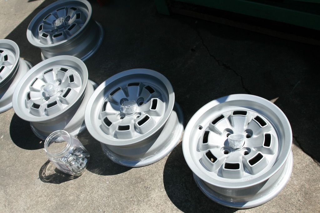

I had some pretty beat up center caps and was able to get them looking good enough to use. They are soft aluminum, so a combination of pounding out the bumps and sanding down the rough surfaces worked, then I had them powder coated along with the wheels.
I guess this doesn't show them too well, but trust me, they look good!
[/img]

Those wheels look pretty good!
