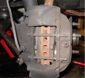

Right then. I had the calipers from my front brakes serviced before Christmas & when I put them all back together I couldn't get a firm pedal. After a lot of bleeding I could get it to firm up but only near the end of the travel & the test drive was not a happy experience. To get the car to stop I had to pump the pedal 4-5 times each time.
I got a length of clear plastic 5mm tube & ran it from the caliper back to the master cylinder (the fuid in the system was completely new by now) & pumped the brake pedal. The driver side coughed up a couple of bubbles then ran clean. The passenger side produced a bubble with every pump for several minutes & never ran out of bubbles.
These calipers are Austin Princess type each with 3 bleed valves (I bled from all 3).
So could there be something up with the caliper that is allowing air into system? Would it be entering through the piston seals? There doesn't seem to be any obvious leak.
I'd appreciate any wisdom before I take the caliper back to the reconditioners.

The inlet is on the inboard side with 2 bleed valves at the top. On the opposite side of the caliper positioned slightly higher up is the 3rd bleed valve. I assume from this that they are cross-drilled. Using this old picture as a reference it's all plumbed up the same as it was before.

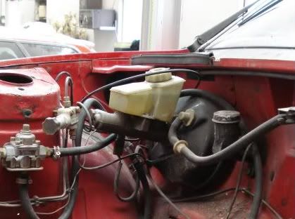

Today I have connected the tube to the solid brake line ie, before the caliper & still get bubbles so I've removed the master cylinder & will investigate replacement or repair. FWIW it has a bunch of numbers on it then it says 7/8 but it looks like the pic below.

Peter, Method 2 is not ideal as you are putting aerated fluid back into the system. Also note that the failure warning switch is still in position (not sure why but you are supposed to remove it for bleeding, I assume it allows the little piston in the bottom of the m/c to move). The bleeding did start from the rear brakes? Looks like a non standard adjustable compensator fitted, might be worth setting it to full front (counting turns)to flush any air out?

Both methods produce the same result but method 2 is a lot faster. I have done some research & might look at building a pressurising gizmo for future bleeding efforts. My intelligent [:p] use of the Search feature on this forum suggests I have a worn master & that with dual pot calipers I should upgrade it in any case. The pedal travel had always been a tad longer than ideal. The No.1 choice would be a Sherpa but is not practical due to unavailability in NZ (did you ever find one Jolyon?) but the No.2 choice, SD1, should be easy to find. The problem will be finding someone who can rebuild them over the holiday period as most places are closed until Jan 5 & I have a club run on the 3rd.

A reconned master cylinder from Jolyon & a proper bleed has restored my brakes to their usual peak efficiency. Thanks for all the help.
