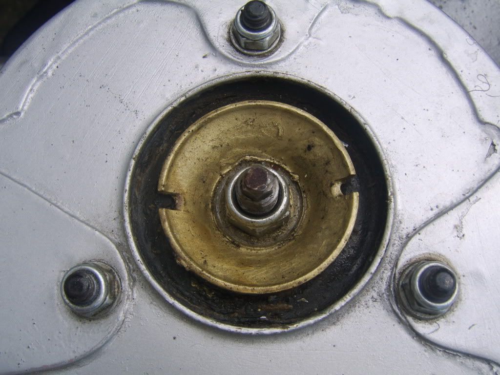

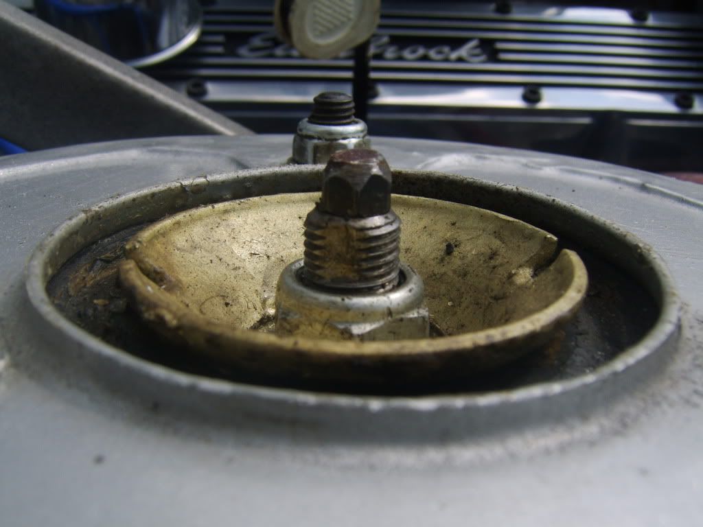

Update: Here's a picture of the top of the strut and how far the nut is on the shaft...

Postby Beans » 31 May 2009 14:30
Something wrong with the dished washer at the top.
That should be able to move up through the hole.
Looks like the top rubber has seen better days.
Or you overtightenedhe top nut and damaged the rubber ...

Postby TR7Aaron » 31 May 2009 14:55
It has cam plates on it and the dished washer butts up against the bottom of them. The passenger side is the same except that the nut is even with the top of the strut shaft.

Postby jclay (RIP 2018) » 31 May 2009 15:22
Top of the strut assembly:

Postby john 215 » 31 May 2009 15:28
Have you refitted the 'cone' part (UKC 7495) [?] or you have pulled the washer through the top mounting as the washer sits on top the mount-

Postby TR7Aaron » 31 May 2009 21:50
Update:
I took apart the driver's side again and noticed that there was maybe 3/4" of threads left on the strut shaft that were corroded. I cleaned them up, re-assembled the strut and re-installed it. This time, I took an impact and really tightened down on the top nut. The nut went down several more threads. Success! No more knocking and the strut is very secure.
