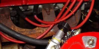

Is there an easy way to clean up my stock exhaust manifolds? They are currently rusty orange with several oil stains as seen in this old picture.
They will be replaced with extractors at some point so I don't want to spend a lot of time on them so it will need to be a spray & wipe solution if possible. Cheers.

As far as cleaning them on the car, a stiff wire brush is about all I can think of - sand blasting would make a real mess.

Thanks for the suggestions. The engine is ex situ with the manifolds sitting on the garage floor but on the evidence it seems like a wirebrush might be the most practical solution. I was hoping there was some aerosol potion that would strip away the crud.
