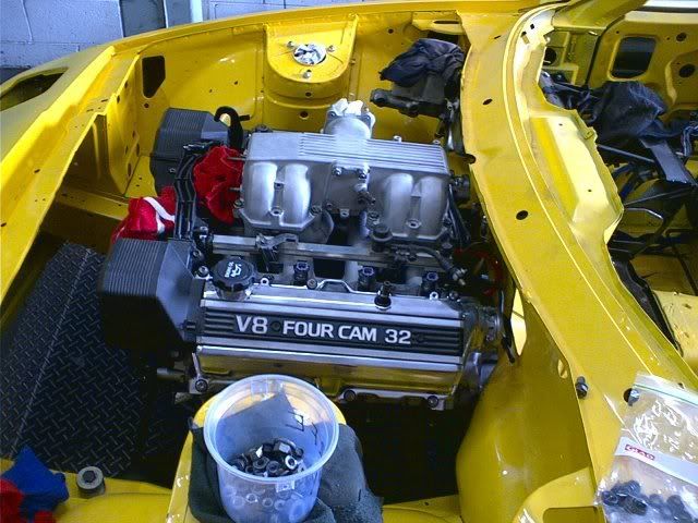

Yes, I did hasve a link somewhere where a Lexus quad-cam was being fitted - seriously thought about that myself, (modern technology), but stuck with the Rover. Besides, the Lexus motor wasn't eligible for what I want the car for!

<blockquote id="quote"><font size="1" face="Century Gothic, Verdana, Arial, Helvetica" id="quote">quote:<hr height="1" noshade id="quote"><i>Originally posted by nadg63</i>
Found a pic!
