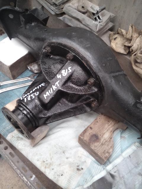

I have stripped my 4-speed axle and now have all of the parts to rebuild it. However, I have been a bit silly and forgotten which side is left or right when it comes to reassembly. Basically I'd like to know if (a) the half shafts are handed and (b) which side the drum back plates relate to.
On the second point, the back plates are stamped LH/RH so all ok. But I don't know from which perspective we are talking LH/RH. So, can anyone tell me which back plate I should assign to which side of the axle?
To make it easier, let me know if "A" or "B" is left side or right side, in terms of the back plate locations, in the following pic
I have just had the bearings and hubs pressed onto the shafts and don't want to put them into the axle casing the wrong way around!
Many thanks, I'll take photos for reference next time I do anything like this!

The half shafts are the same side to side. Did the guy who pressed the bearing on, did he press it on the correct distance ?
There should be a gap of 4.1 mm ( quickly in my head that's about 161 thou in real measurements ), this closes up to the correct depth setting once you install the halfshaft etc back into the axle and you refit the flange and torque the retaining nut up.
The back plates are handed and you will find the parking brake lever slot will only face rearwards when correctly orientated

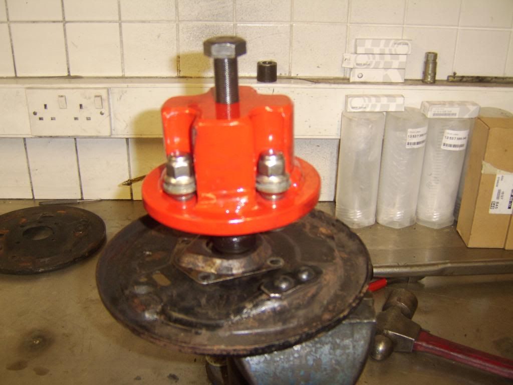

I built a hub remover for a friend a couple of years ago. We didn't know they were available.
He has a string of Herald based cars, Herald, Vitesse, Spitfire and GT6 and was always
trying to remove the hub to replace bearings using heat, prayer, violence etc.
This made it easy, just tighten it up and hit the outside if the taper with a drift.

The hub pullers look great and I wish I'd had them when I started this job! I also remember doing a similar job on my Bond Equipe, which involved using a special tool for jacking up the leaf spring in order to free the rotoflex couplings. But that was ages ago....
