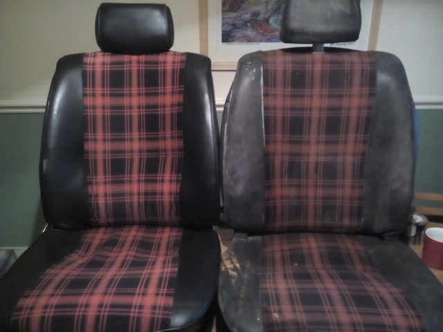

Colour - yep, I'd clocked that it is CAD and will certainly be painting it in that hue. Re the trim, I have new door cards in the correct colours and have just rebuilt the seats. The one on the right is as dragged out of the shed after a 20 year period of hibernation, and the one on the left has been refurbished (I later corrected the rumpled cover on the base). Frames painted, covers through the washing machine and invisible repairs made, cushions re-padded etc. I re-made the padding for the head rest as what was inside crumbled to dust!
Now I just need to find out about the wheel trims and ride height.
