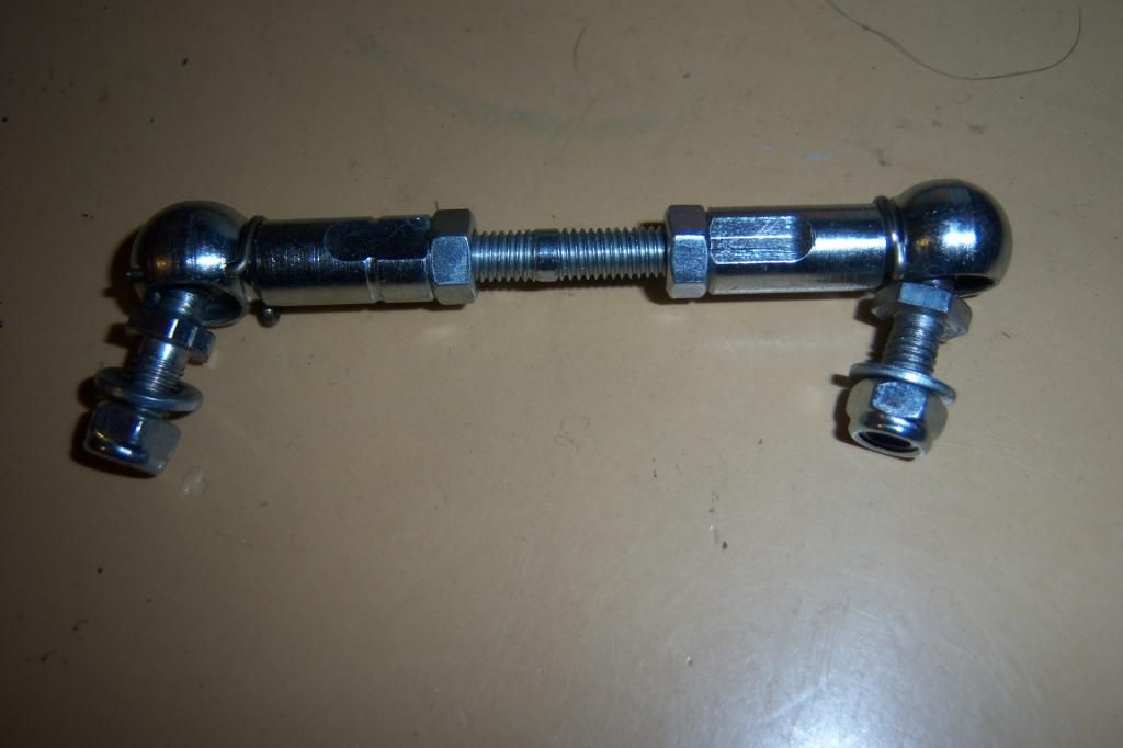

Following Beans' example I purchased this
This was an off the shelf Weber part and as such was relatively expensive.Fitting involved removing the carbs again after the waterpump repair but was otherwise straightforward.The action is so improved that I have had to relearn to drive the TR7 again.Previously you subconciously pressed hard on the first part of the throttle to overcome the initial reluctance to move,now this results in overrevving and subsequent stares from pedestrians.Never professing to be a good driver it has taken a few drives to get used to.Must have been accounting that prevented this from being installed from new.Wothwhile modification?Definately,Steve..

Postby sonscar » 22 Dec 2014 20:40
Came from Ebay seller,not sure which one but the shortest lh/rh thread linkage available(44mm?)Bolted directly in place of the bent wire and adjusted to the same length.Completely altered the throttle feel,now veery smooth.Steve.P.S cost £15.00 probably could have been done cheaper but sometimes the small problems acquire an unjustified massive response.
