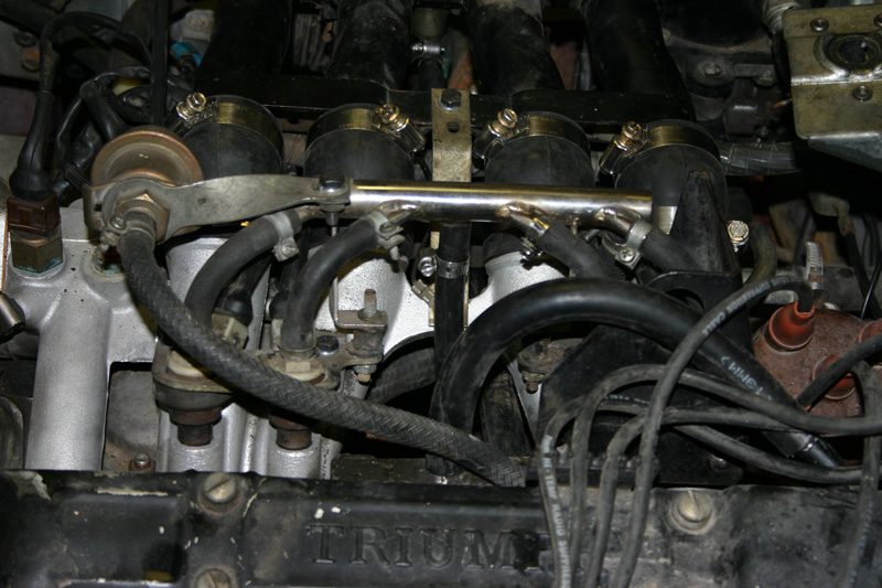

Here are some pics from my resurrected FI. I have never worked on a FI car before - it wasn't bad. The only wires I had backwards were the ones near the thermostat hosing. If it's sat for too long, have the injectors sent out to be serviced - there's a 5th injector (cold start valve) hidden under the big plenum.
http://www.tgnagy.com/tr7/fi.cfm
