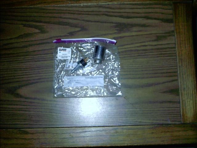

Postby Workshop Help » 30 Jun 2014 23:32
My friend, you're over thinking the problem. Please go ahead and buy the three prong sending unit, they are all the same. To make life even easier, buy the sending unit that has the longer stem.
Postby FI Spyder » 01 Jul 2014 13:07
Not sure which car took what but my July 1980 build date California FI Spider has a one prong and my local early 1979 Yellow TCT has a three prong so I have to stock one of each as a spare. Adapters etc. are just another connection to go bad, come off etc. I'd get the right sensor rather than fool around with the wrong one. They aren't that much and you could probably sell the one you don't need at a car show to someone that needs a spare.
Postby Workshop Help » 01 Jul 2014 14:35
Please, go forth to the auto parts store with your old sending unit in a zip lock bag. Tell the parts guy you want a new unit with a longer stem.
Yes, they do have one. It is a Standard Brand, Part #PS64. They may also have the Borg-Warner brand, Part #S697.
If you tell the parts guy what car it's for, he'll get a kind of constipated look on his face. Just tell him it's for a 'Special' project. Go back to the stock shelves with him to see what's there.
Or, you can go to Rockauto.com and get one for $9.48 plus shipping and if you ask all pretty please with a smile in your heart, I'll even tell you the secret code to get a 5% discount.
You will also find it handy to have the special socket to remove and reinstall the sending unit.
As our illustrious friend above notes, having a spare along with the special socket in a zip lock bag in the glovebox ensures you will never have this problem again, ever.
Buy it. Install it. Live a long and happy life.
