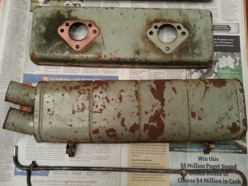

Postby whitenviro » 25 Jan 2014 00:27
My brother is a chemist and he turned me onto sulfamic acid (NOT SULFURIC) as a gentle cleaner for rust. It is used in a lot of household products like Lime-Away. It supposedly has the advantage of leaving a relatively bright surface that won't tarnish again as easily. I found a tub of the powder at a local hardware and have used a weak solution of it a few times with good success.

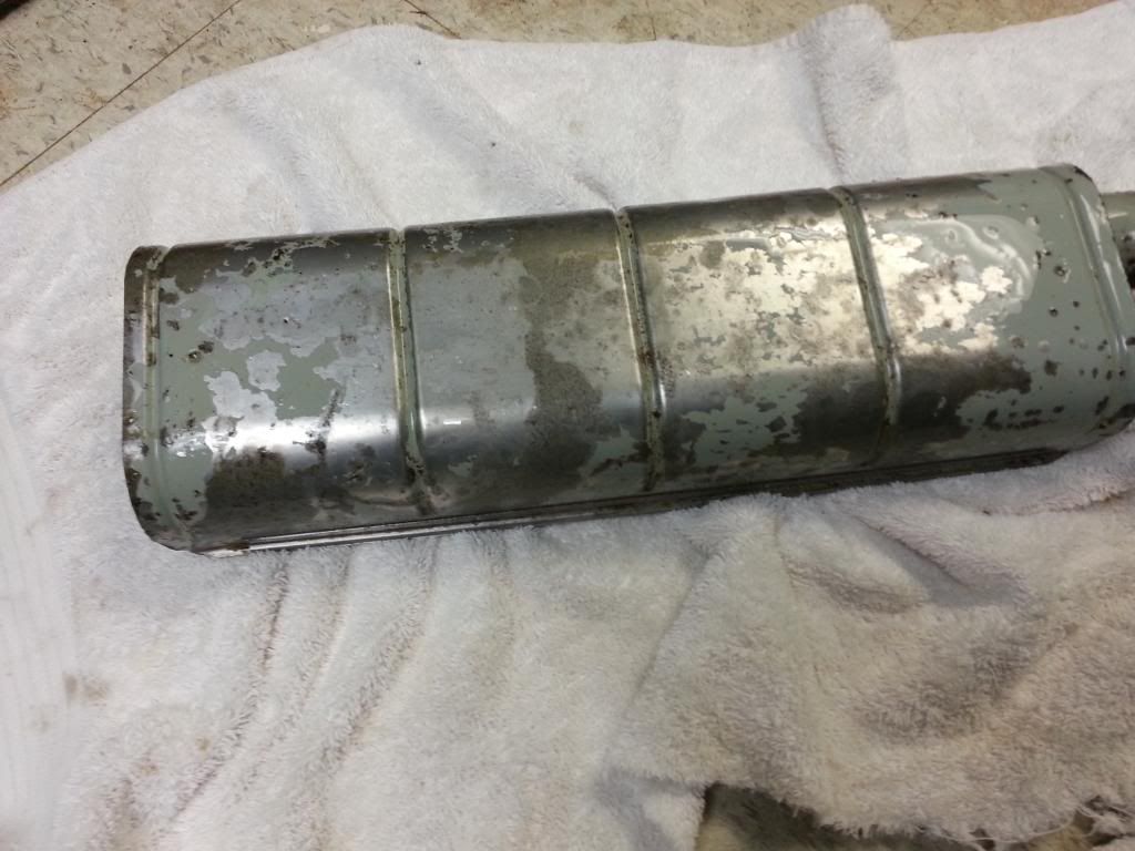

This topic gave me the bump to start a little batch of rust removal on some parts I have been gathering. I started with a low priority item; my Sprint airbox. It had a lot of surface rust, but nothing too deep.
I mixed a weak batch of sulfamic acid at a about half of the recommended concentration used to clean grout removal. It then got diluted again as I topped of the tub to cover the part, so it was about 1/4 strength. After 24 hours and a couple rounds of light scrubbing with steel wool or a toothbrush, it looked like this:
Still a ways to go, but a lot had come off. It has now been about 36 hours and that extra time has made a lot of difference. I will pull it tonight and give it a good scrubbing, but most of the paint is gone and the remaining rust spots seem to wipe right off. Next time I won't even bother scrubbing much until at least 24 hours.
I'll post more pics as it gets closer to finished.
