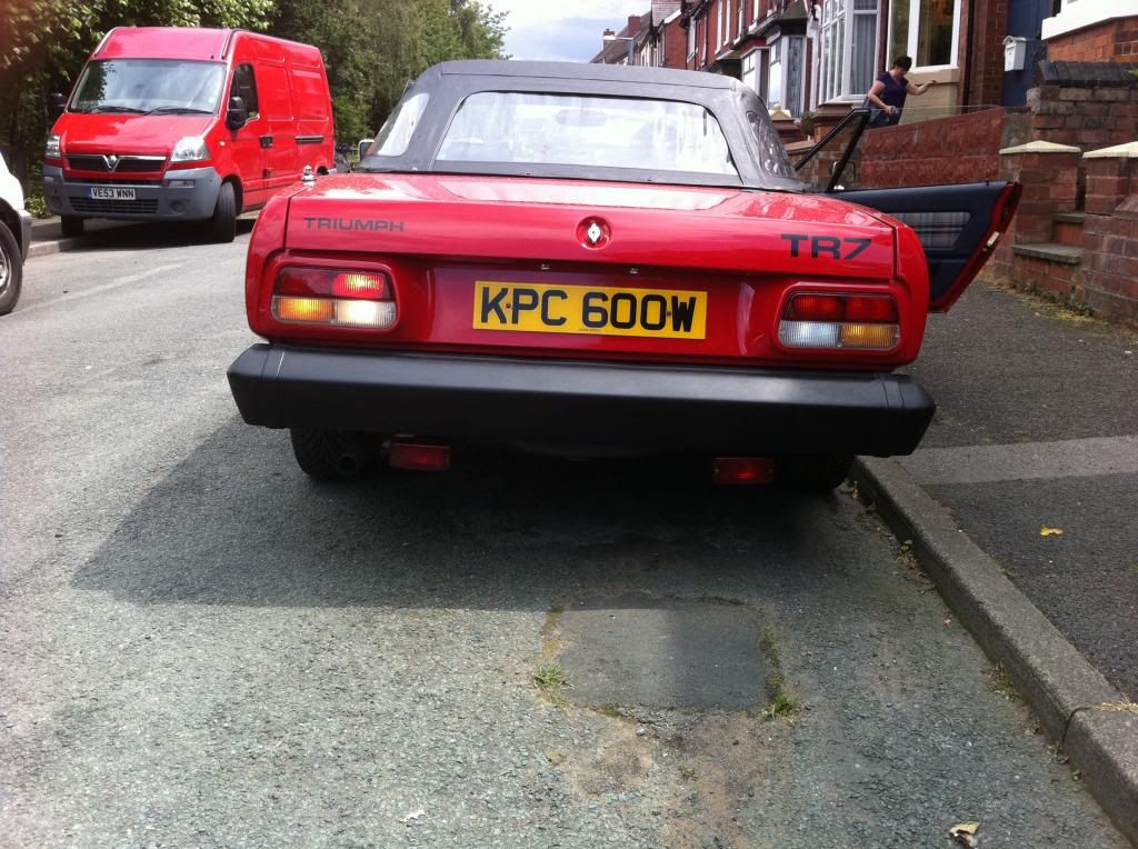

Well I've been down this expensive route and here are my findings lol
The left hand side is standard bulbs while the right is LEDs, during the day you can't see the LED bulbs and the standard bulbs are much brighter.
During the night the LEDs are slightly better (couldn't find photo sorry)

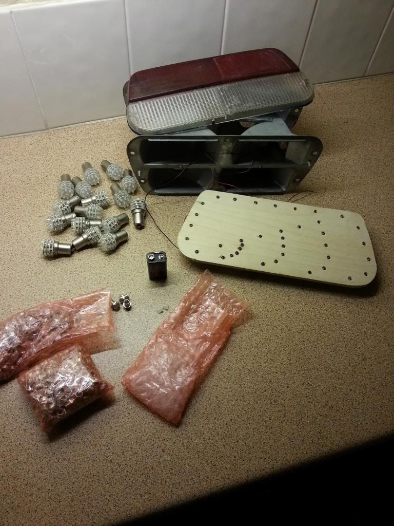

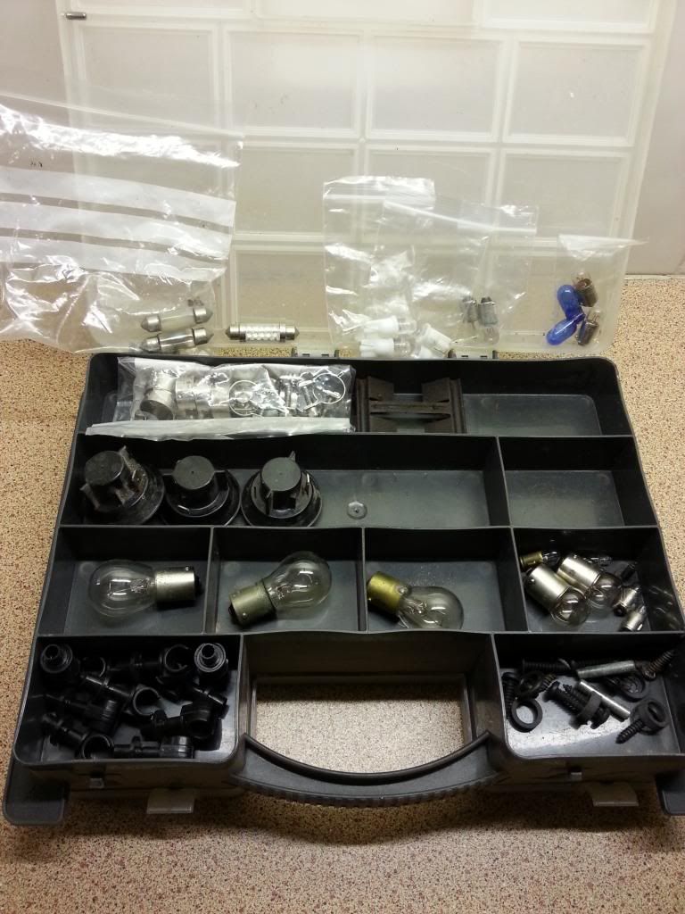

I replaced the complete car with LED bulbs (Interior and Exterior)but the majority started to fail and/or flicker after no more than a few months (Cheap bulbs?) so I have reverted back to standard all round.
After being rather disappointed with the results I went and purchased all the bits to wire up, design and create my own using White, Amber and Red LEDs and a clear perspex lens.
Unfortunately this project has been put on the back burners, but you do need to get the correct bulb colour behind the correct colour lens for any light to appear.
That's why I was going to have coloured LED's behind a clear lens

Looks to me you used puny 36LED bulbs?
I use:
105LED red bulbs for Brake/Rear lights
63LED white bulbs for Reverse lights
56LED amber bulbs for Direction indicators
and I'm most satisfied with the intensity of the lights. Day OR night...

<i>I replaced the complete car with LED bulbs (Interior and Exterior)but the majority started to fail and/or flicker after no more than a few months (Cheap bulbs?) so I have reverted back to standard all round.</i>
I'm suprized this happened, in my experience even cheap LED's are reliable. Being a cynic I suspect that typically they are all cheap, dearer ones are often perceived to be better simply because they cast more. Yes you get what you pay for, unfortunately you sometimes pay for someones 1000% mark up. Am I right in thinking that replacement bulbs to the outside of a U.K. vehicle should have e approval, or does that just apply to the light unit itself? Regards, supercass
