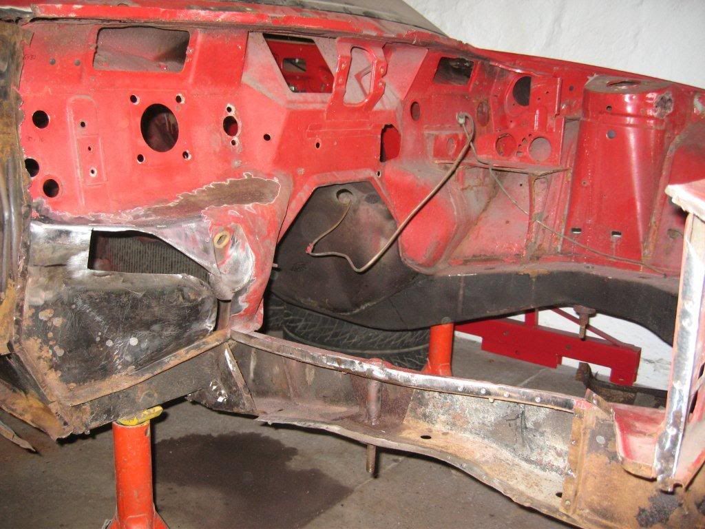

I have on a 7 never replaced the wings, but I have somewhere found a picture without a wing.
[img][IMG]http://i189.photobucket.com/albums/z26/TRHENK/dr-inner-w-arch.jpg[/img][/img]

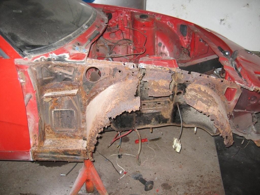

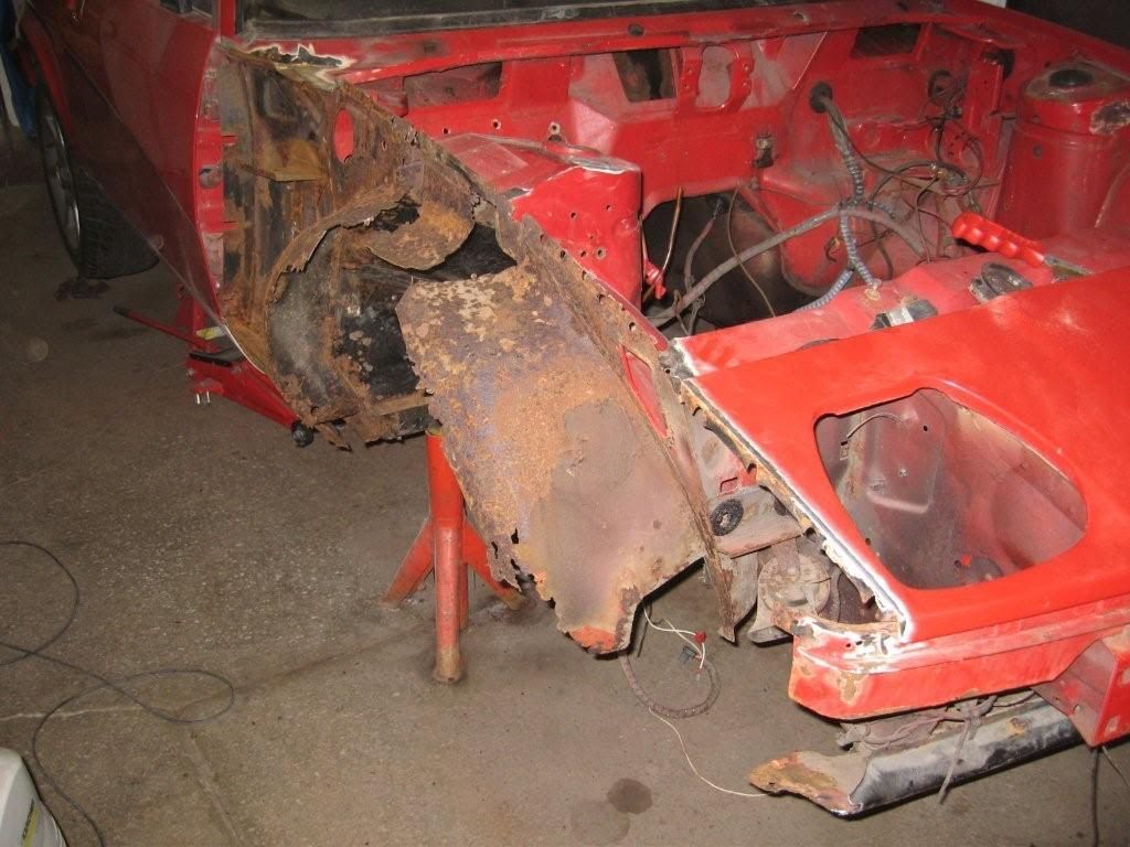

just taken the wing off mine for the same issue. Hope this helps (Rust Restorers website was really helpful for me and so was Beans blog)
I ended up go further !

Postby MrT » 23 Apr 2010 20:14
Ouch! I hope mine's not that bad!
