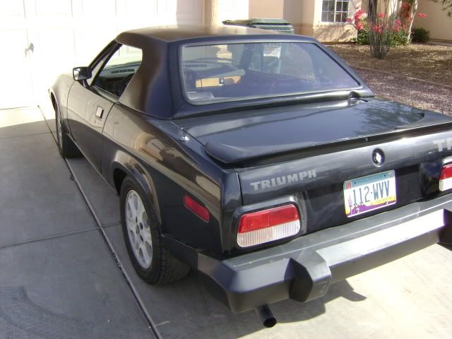

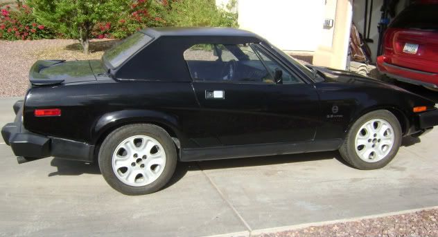

Actually I need to put on more weatherstripping and a headliner, but visually from the outside it is finished. I have been working on and off on this project for over a year and a half, and it feals really good to have something that looks complete.

It does look like a job nicely done. It does look like there is a fair blind spot. Is this the case? Extra care, shoulder checks, might be the order of the day.

Postby RJS » 30 Nov 2009 13:32
I have not driven enough to know how bad the blind spot is yet. Having good convex mirrors would probably help more than anything.
jclay - No orders yet. I have enough supplies on hand to do one more top, and that will go to Zeke (if he still wants it). Unless I can get a lot faster and better quality with my fiberglassing, there will not be too many of these built. My dream was to build and sell these for around $600, but the cost of supplies and time to build are much higher than I thought it would be. Time will tell. They will go onto the for sale area if it ever gets to that point.

Postby Workshop Help » 30 Nov 2009 13:56
Would it be too rude to respectfully suggest a round port hole there in the blind spot? We have pondered that idea for our TR7 for many years.

Postby RJS » 30 Nov 2009 15:39
Mildred,
You are not the first to suggest a "port hole" window. There is no reason it could not be done, but it does not suit my personal taste. The old t-birds had a port hole window and a few newer chryslers had them too.
I think the blind shot should be only a little larger than what is on a FHC.
Rob

Postby diver » 30 Nov 2009 15:52
RJS,
It doesn't look like the blind spot is much larger than on FHC.
With no top, no blind spot.

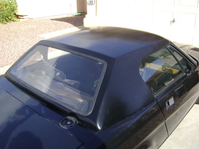

It looks great. It's a shame we can't get a window on the side that isn't a circle. Pop up sunroof, just for kicks. Try some heavy felt or thin indoor/outdoor carpet for the interior.
I know this was quite a labor, making the blank, then the mold, then the new piece. I've seen the photos...
Is the rear window polycarbonate?

Postby RJS » 01 Dec 2009 19:36
Hi Tim,
It took me a while, but with a LOT of advice from you I got one done (at least the fiberglassing part is done).
You have heard about seveal of the mistakes I made along the way and more than anyone, you understand how in the dark I was when I started this project.
Yes it is polycarbonate from Laird (another idea you gave me). I really wanted a little bit of a curve on the back, and the polycarbonate has just enough flex. I still have that back glass from a FHC that I originally was going to use (if anyone needs one).

btw, i really like the size + fittment of the backglass, personally I think a nice add-on would be triangular rear quarter windows resembling the ones on the convertible roof......
