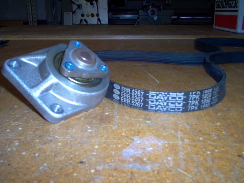

Approx 5 years ago I bought two complete TVR450 engines. I stripped them down to the short blocks and reassembled them to according to my specific requirements. There are quite a few differences between a normal Rover V8, but suprisingly few performance upgrades. These are all the differences from the normal 4.6 that I can remember:
Oil pan was steel Land Rover type except no oil level sensor hole and the shallow end of the pans were "modified" ~1/2" because of the longer 4.6 stroke.
Intake plenum has a 450 emblem and the intake runners were shorted by 1 inch. Valve covers have TVR emblem.
Custom chip for the ECU.
Pistons have 4 cuts for high lift valve clearance. TVR(part#) camshaft with large amount of lift and duration. Vernier(infinitly adjustable) timing chain.
Cyl heads were stock. Comment: Makes no sense because if I could only make one modification to any RV8 it would be cyl head work.
1995 RR classic type distributor with remote amp. NGK part# B7ECS spark plugs.
Intermediate front engine cover. Power steering pump replaced with "a large bearing". Alternator mounting bracket lowers alternator (but not enough to close a TR8 bonnet). Serp belt part# ERR5267 ~1850mm long. No A/C.
One engine had a factory made 27lb flywheel. The other one had an 18lb flywheel with a TVR part# on it. The standard RoverV8 flywheel weighs 32lbs.

Here is a picture of the TVR "power steering pump" and the belt:
