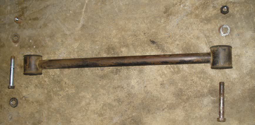

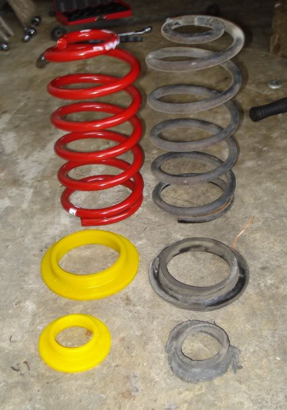

I did the left rear spring today. It was a far easier job than I thought it would be. Undo the bottom shock mount & jack the car up & voila! The springs falls out. Getting the tie arm off was harder. The new spring is Rimmer's 'uprated' part so I hope it can handle the weight of 4 race wheels in & over the boot better than the old ones. Being marginally shorter than the old springs wasn't a good start but at least the new poly insulaters have a bit more meat to them.
Looking at the tie arm I can't see much wrong with them. The rubber bushes look solid, the mount holes were round & the bolts were still shiny. Only the nylocks nuts were a bit weather beaten. These thick washers you speak of Hasbeen. Are they thick as in large diameter AND in actual thickness of the metal? These are the bits that came off. The washers are very normal looking & one was missing from the axle end.

What is the springs rated at that you purchased from Rimmer's? Were you able to buy just the rears or did you have to get a set?
Those yellow pads make the red springs look sharp.

Peter, the OD of the washer is as large as the OD of the bush, or
perhaps a little larger.
The thickness is at least twice what you will get as an ordinary
washer for that bolt diameter.
I had to go to a tractor place to get the same OD, & thickness as
was on the 7, which I believe was stock. Probably could have got
them at a big bolt place, in the industrial area of the big smoke,
but who wants to drive in there?
I'll see if I can crawl under one of the things tomorrow & see what
they are, it's a while since I looked at them.
Those in your photo are far too thin, & too small. I can see they
are distorted from the compression you've had on them, even with
these old eyes.
