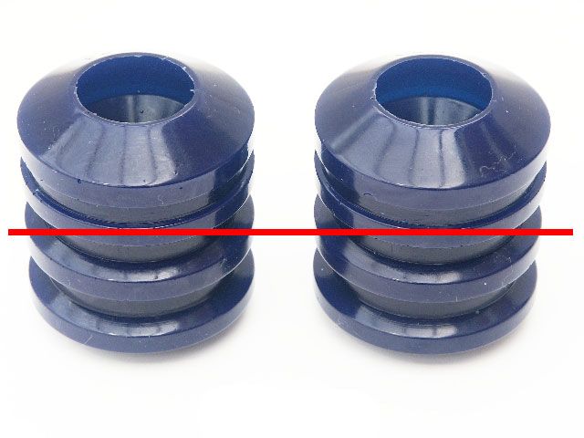

I shortened the Australian made SuperPro version (SPF0189K) of the UKC1101 bump stop by cutting off the collapsible portion on the bottom of the item along the line indicated in the following picture.
From memory, this reduced the height by ~15mm, leaving the bump stop <40mm high overall. I really agonised over whether to make this cut but am glad that I did. The car only hits the stops when I have run over very deep pot holes.

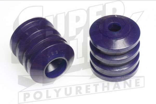

You can buy these in the UK under the Super Flex brand name.

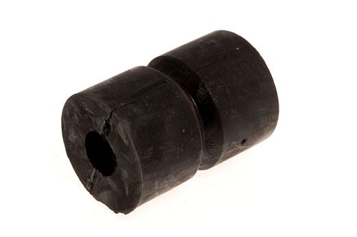

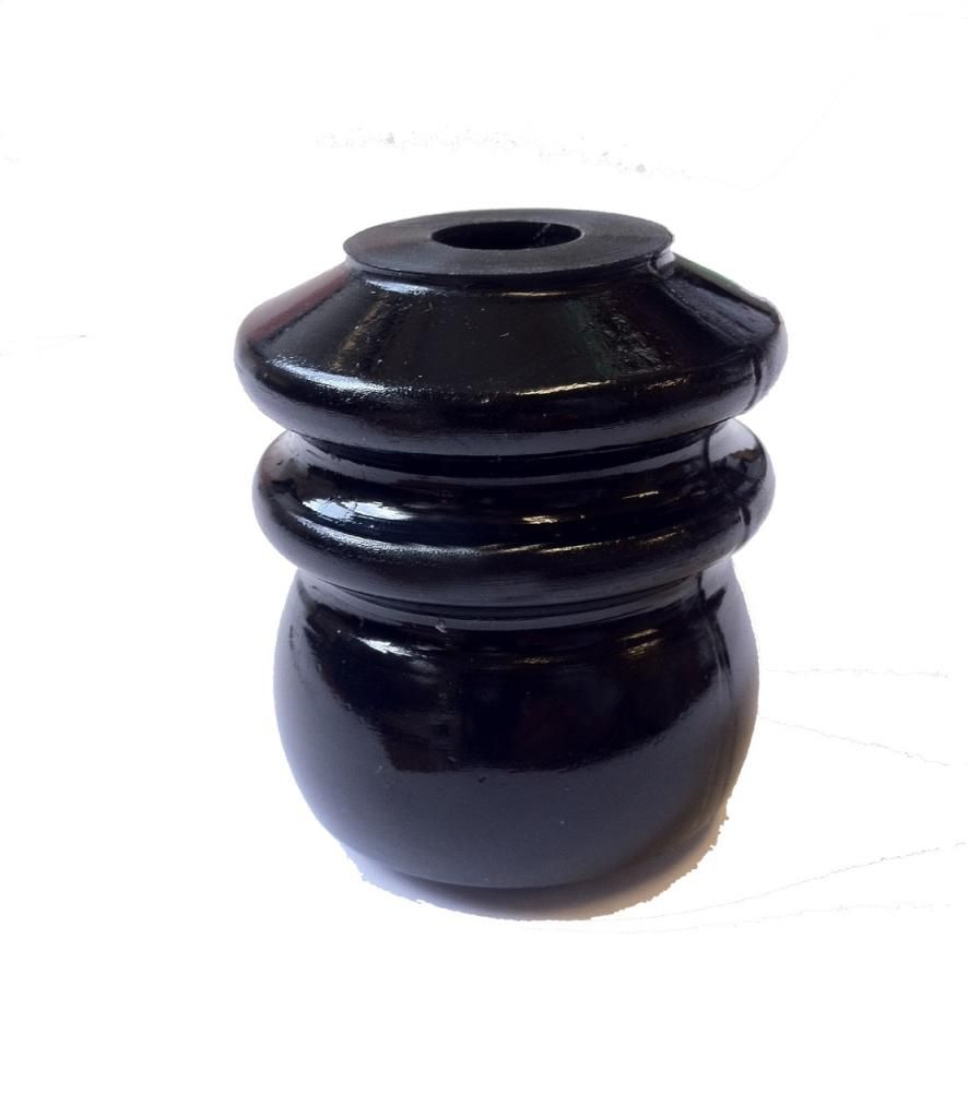

Alternatively, you could try either the Rimmers or Wedgeshop versions, each illustrated below:

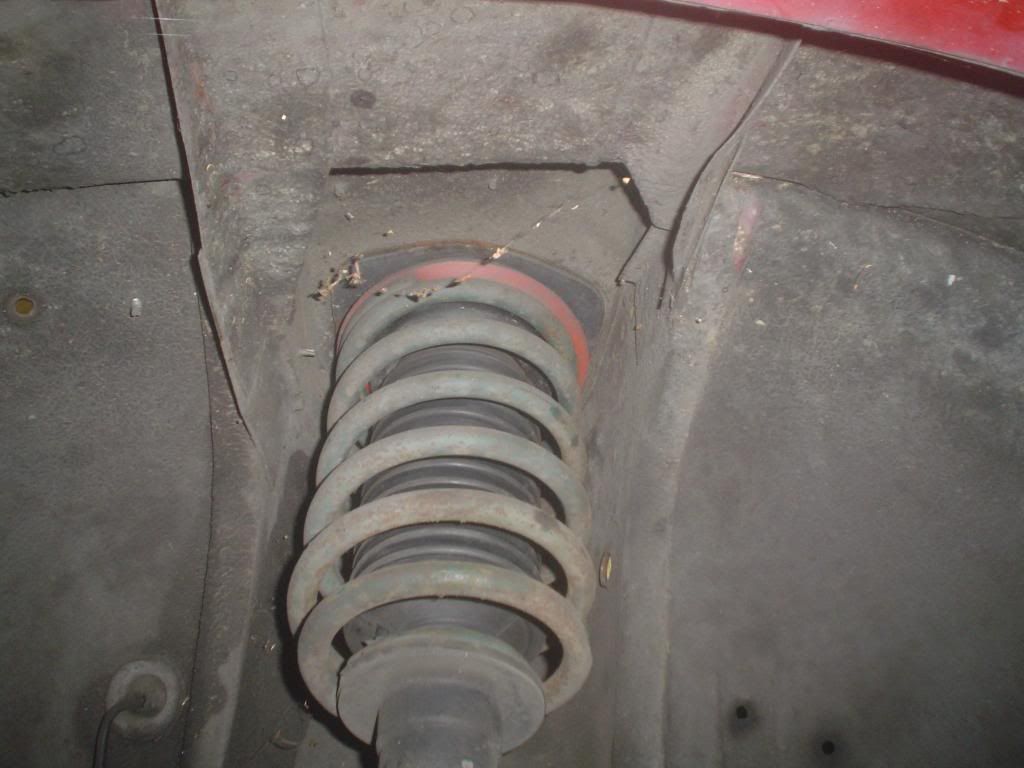

This is sounding an awful lot like the problem I was having. I could put my weight on the front fender and would get a small bit of travel before I would hear a clunk. When driving it felt like there were 2x4s up front top rather than springs. I had purchased brand new standard springs from Rimmers, this shouldn't be happening! I showed the pics to some of the suspension pros on here and they informed me they springs were not correct. But yet I did order the correct part from Rimmers, and I did get the part I ordered! This is the spring from Rimmers installed.
See how squished it is! I had my mechanic watch as I put my weight on the fender, that clunk I was hearing was the spring fully compressing! So, we found a pair of original springs from his junk cars and put them on. See the difference?!
What a massive difference! It feels like a brand new car, even with 34 year old springs!
