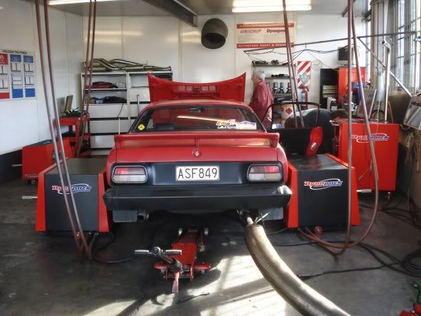

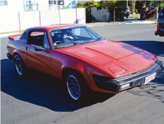

Postby PeterTR7V8 » 27 Oct 2008 09:04
That big winged rally car is unique & I don't like the roof spoilers much. This is what mine looks like:
and this video shows it better
http://www.youtube.com/watch?v=wALGc0x2KJo
But it is no longer attached as of this afternoon.
I totally agree that for road use a wing is pointless and in fact it is probably detrimental to fuel economy. That's why I thought about having some kind of temporary arrangement for club days at the track - maybe about 7 days in a year.
As usual I'm looking to have my cake & eat it too.

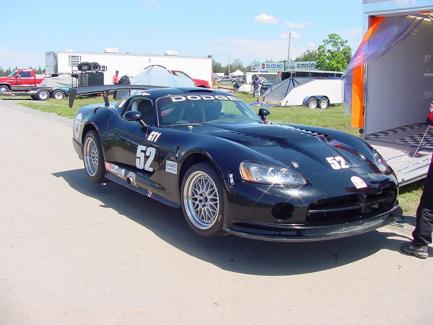

Postby tr8 » 27 Oct 2008 12:00
Here is a picture of a factory Viper that races in the same class as the red TR7 with the 350 Chev in it. Spoiler must work.
Postby PeterTR7V8 » 27 Oct 2008 17:46
I think the thing on the back of the viper is a wing. It's purpose is to create downforce. What the Group 44 car has is a spoiler which aims to cancel the lift that is created by the air flowing over the roof creating a vacuum behind the rear window. It would be the near vertical spoiler that I would want on my car on race day.
