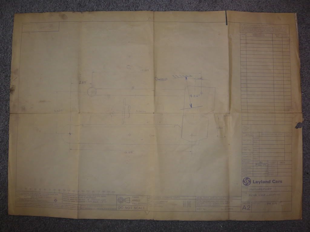

For race and rally the upper swing arms were made to be parallel to the lower arms in order to stop pulling the axle tubes out of the differential casing. The angled original arms pull out when the suspension goes up and the effect worsens with harder bushings or hiem joints. Here is a drawing that I got when I bought the TR7 race car that I restored (It had this set-up).

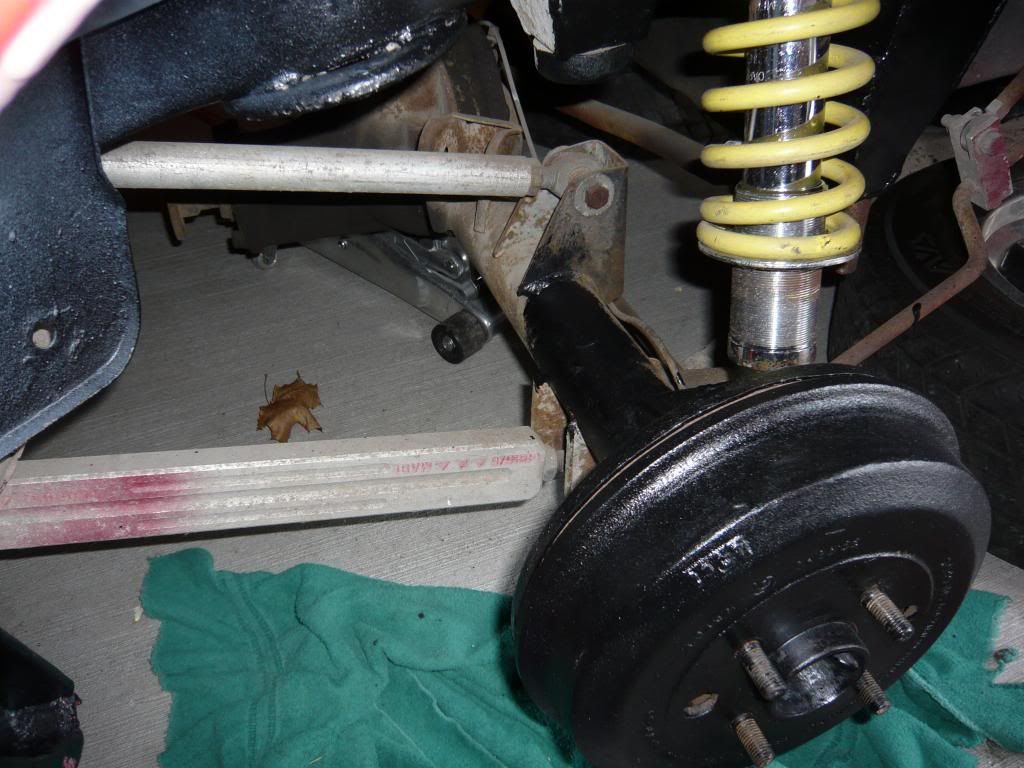

You can see the original angled mounts in this picture.

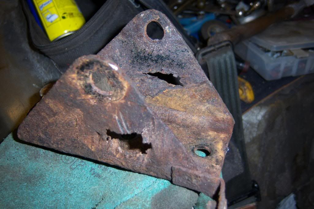

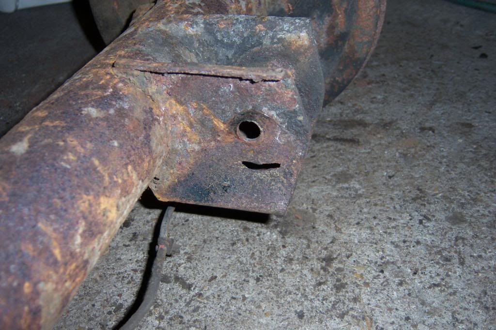

I'm not sure if I described the corrosion I had to cut out and replace clearly.
It wasn't on the rear axle's brackets but on the rear floor pan and bulkhead close to where the lower arms locate. The stress cracks ran about an inch above the spot welded join with the floor pan, all due to rusty wafer thin metal. That caused rear axle steering as I accelerated hard up Elstree Hill in second gear.
A year or two later I noticed paint blistering on the floor behind both seats. It was directly above the lower arm mounting points, the contour looks like a large builders boot toecap when viewed from above. I sourced the repair sections from Robsport (but haven't found them on their website to post a link) and spent a hell of a long time welding and fettling them to fit as it was far from simple for my limited experience back then. Underneath the mounting point there's a thick gauge steel strap that bridges across It. I had to remove both of these to make my repairs but welded them back in to give as much strength as possible. I know some folks don't keep them after letting in new metal but I reckoned that the shell needed as much strength as possible since I'd doubled the power with the V8.
