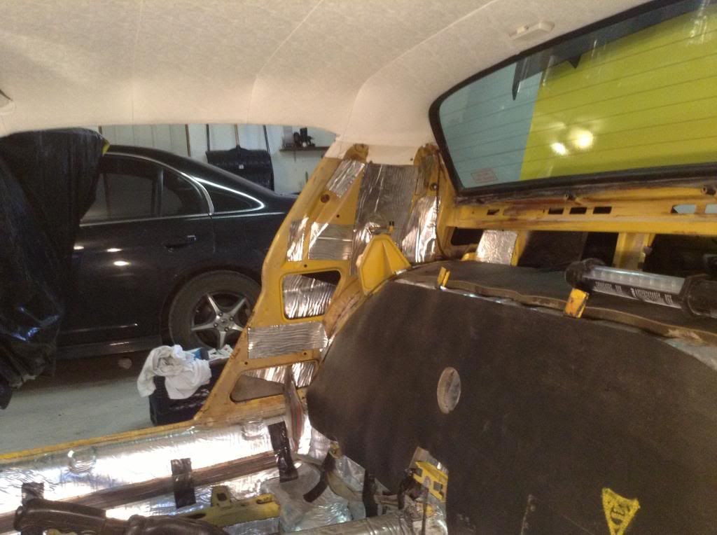

Postby fastman » 25 Apr 2014 00:58
This is the shot of the butle rubber/ foil sound deadening over the sills and just about everything

Postby fastman » 25 Apr 2014 01:01
Closed cell foam for extra quiet comfort under the feet and seat
