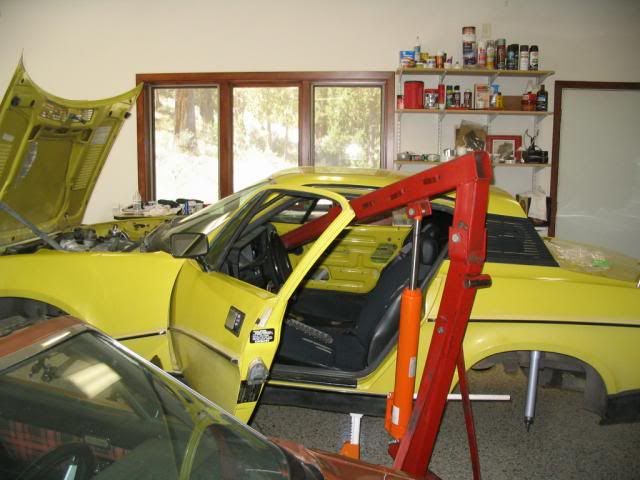

Here is another variation for lifting the gearbox to the correct height to align with the engine. You work the crane through the hole in the tunnel.
Image[/URL]
Image[img][IMG]http://i615.photobucket.com/albums/tt234/nickmi/TR7%201975/Yellow.jpg[/img]

Postby Workshop Help » 26 Jan 2014 02:11
Nick, shame on you! This is just plain cheating.

Postby FI Spyder » 26 Jan 2014 12:59
<blockquote id="quote"><font size="1" face="Century Gothic, Verdana, Arial, Helvetica" id="quote">quote:<hr height="1" noshade id="quote"><i>Originally posted by nick</i>
Wow, that's got to be like assembling a ship in a bottle using a construction crane.[:p]
I'd try that with a Spitfire were you can lower the whole transmission in from the top through the huge transmission tunnel but I wouldn't try it myself.

Postby Cobber » 27 Jan 2014 10:11
Doubled up the message for some reason?
Postby Cobber » 27 Jan 2014 10:13
I've always used this method for removing and refitting the gearbox/transfer case assemblies form Landrovers S1, S2 and S3.
