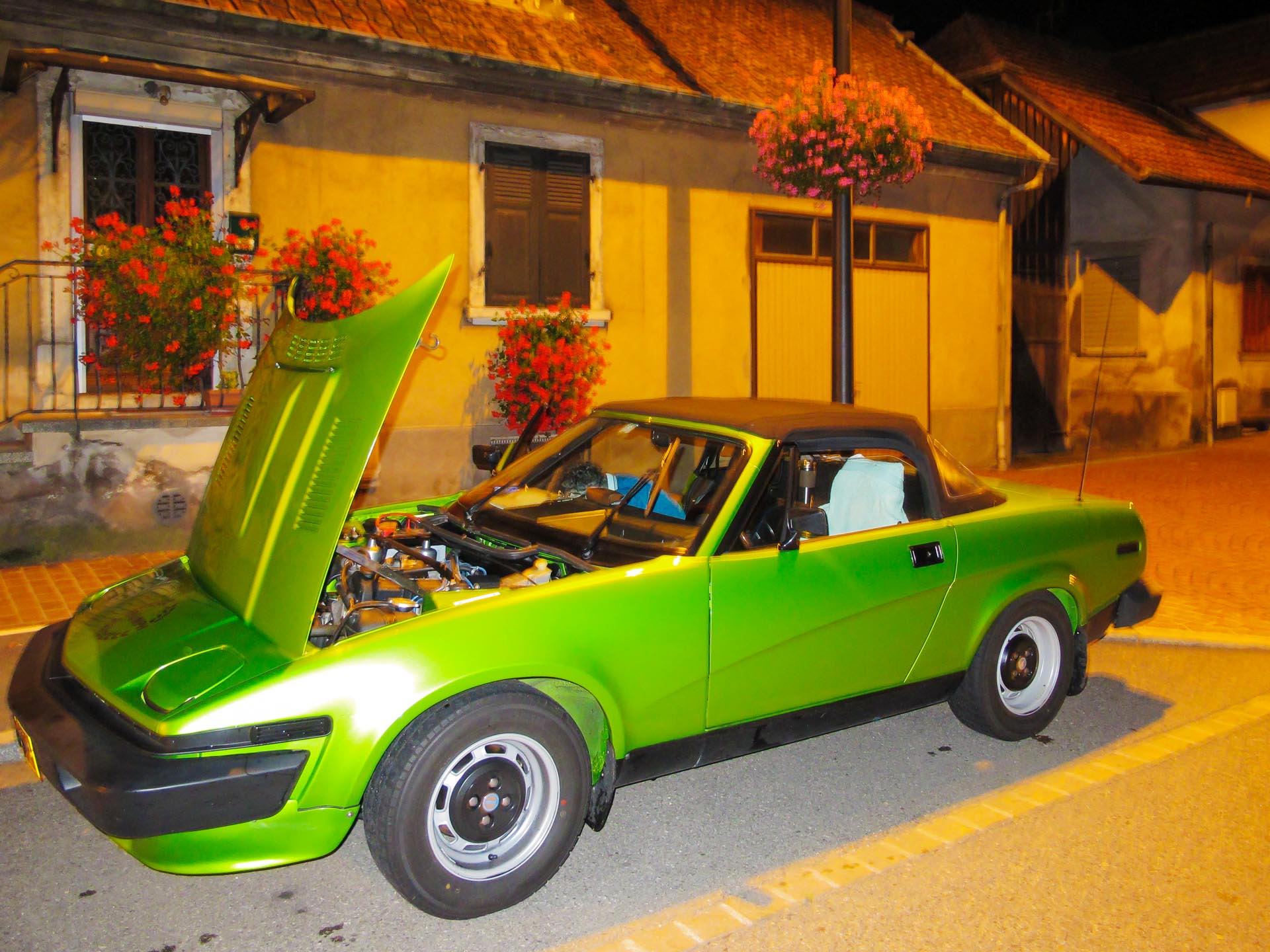

Hiding behind these steel wheels ...
... are these uprated vented brakes (only needed a slim spacer to get enough clearance)
