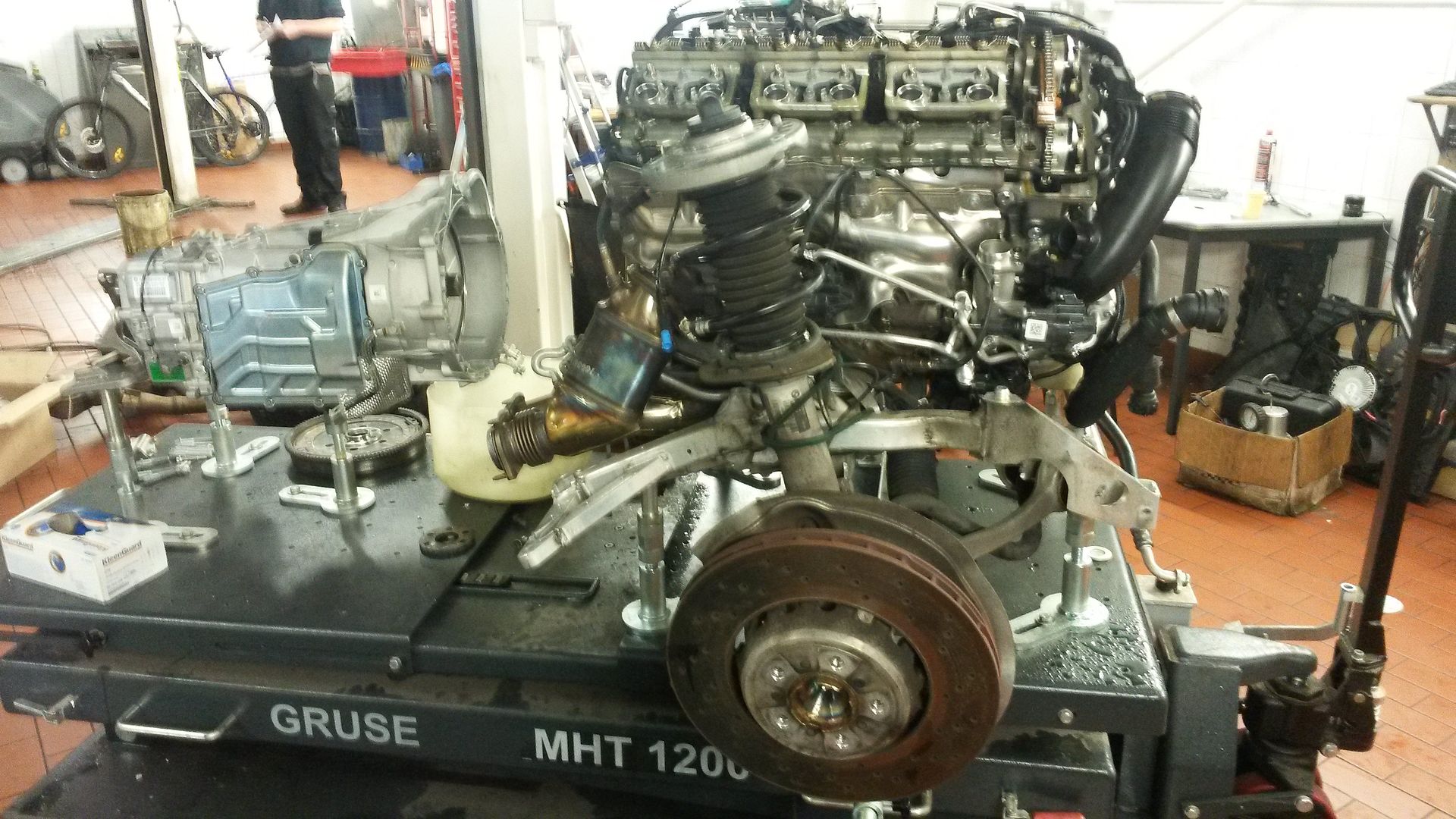

Sort of on the subject of engine removal but not our car's, we remove a lot of our bigger engines at work ( 6,8 and 10 cylinders ) from underneath. We use a special lifting platform that will wheel under a two poster ramp. It can pumped up to rest under the subframe and gearbox, there a dedicated set of pins will locate in the subframe and gearbox, you then all bolts holding the trans and engine and lower the whole assembly. It even possible to separate the engine from the box by undoing all the bell housing bolts and sliding the section of the bed apart.
Here's picture of a M4 engine I had out last year -
