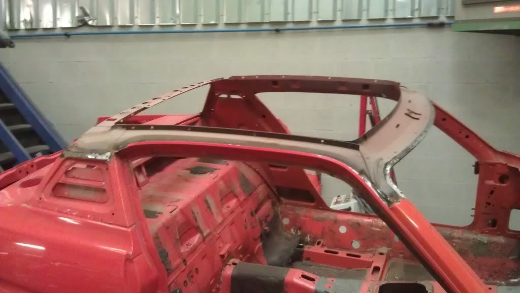

Postby march » 04 Jan 2015 15:16
No - This was on Ebay. Picture of the shell attached

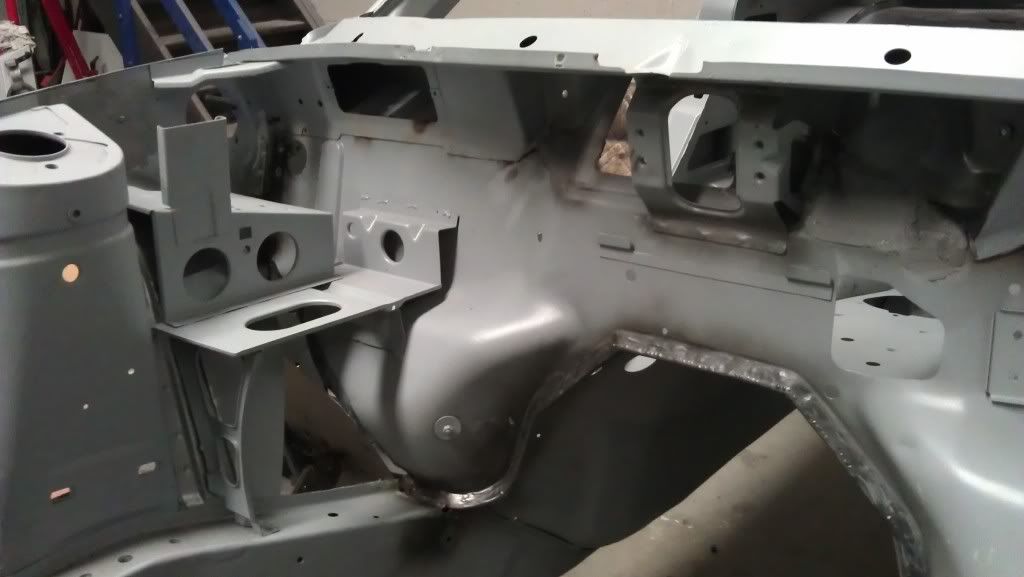

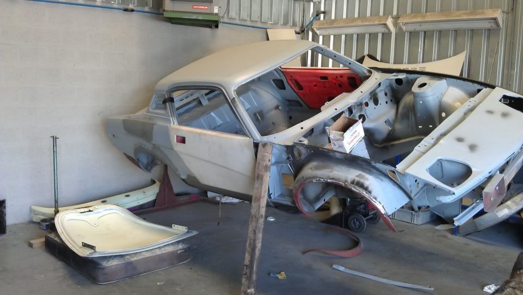

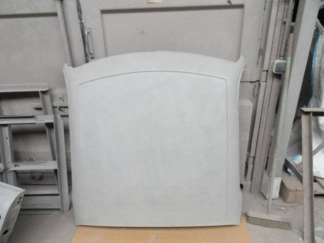

I will post Some pictures. I welded a LHD bulkhead in and a solid roof. It was not so much work. Only a lot of spotweld- drilling ;-).

Bulkhead:

Roof:
