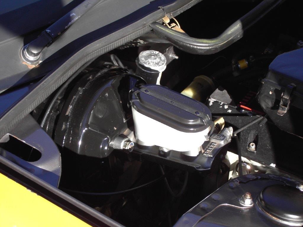

PBR 15/16" Master Cylinder and servo from a VS Commodore.
Craig
TR7V8 with PBR 15/16 Master Cylinder....

Postby scotty » 03 Sep 2014 10:09
Hi Craig.
Apart from the pipes, did you have to do much in the way of mods to make the VS parts fit?
Thanks
Scott.
<blockquote id="quote"><font size="1" face="Century Gothic, Verdana, Arial, Helvetica" id="quote">quote:<hr height="1" noshade id="quote"><i>Originally posted by Craig C</i>
Craig
