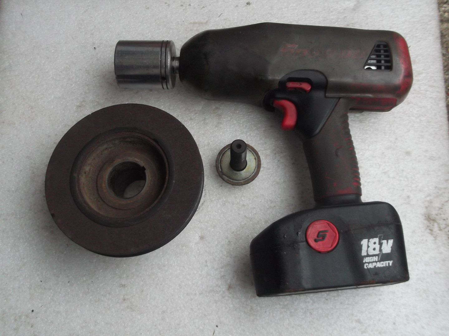

My preference on something like this is wire brush with drill excess rust off exposed threads if you can get a brush on it, it's pretty tight in there so might have to use one with bristles facing forward. Then use an air impact wrench, the constant banging will knock the nut loose sooner than later. They also make electric impact wrenches but never tried them as I have a compressor. The studs are big enough they shouldn't break but most impact wrenches have an adjustment and you can start more gentle and work up. Heat the nut if all else fails but you shouldn't have to go there. I tend to use penetrating oil only on smaller stuff that would break under an impact wrench.

Like yourself I too have a compressor at home but also have a electric impact gun and found them, have both 3/8 and 1/2 inch drive and found them to be very handy. Half inch is very powerful, I would say a lot better than cheap air wrench. Downside is being Snap On not cheap over here [:(]

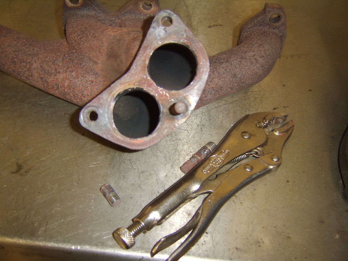

Heat was a total waste of time, Never budged the nuts at all and yes i got them red hot, The nuts required a 17mm socket, I have a deep one ideal. Next the air wrench. Hooray after many attempts the first nut came off. Great stuff, Were on a winner. WRONG the next attempt, stud snapped. 50% at the moment, Stud/nut three, the one at the back. Snapped off on first attempt, By the way this is Four hours after start. so 33.3% success.
After much struggling I drilled out one stud by using a an air drill with an ever increasing size of bits, new stud fitted ok. 66.6%.
Last stud, Total disaster.
Broke about an inch from manifold. Dremmel to the rescue. cut it flush to the manifold with cutting disc. centre punch and drilling again, same procedure. but could not get drill the correct angle.
So sorry to admit. a none std mod had to be done. a slightly oversize hole drilled. ground off one edge of new bolt hammered into position and will be fastened with same size nuts.
