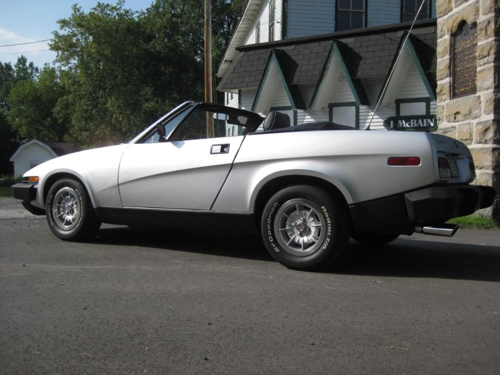

Postby FI Spyder » 12 Mar 2014 15:04
Not sure how you can hear the center resonator, it should have a muffler after it. I fitted a Magnaflo SS muffler ($86 after discount) had a muffler shop weld it on as well as weld on my Thrush muffled exhaust tips that I liked the look of. That plus some additional tip hangers came to another $45. It's usually the muffler part that rusts out as it is the last part to get warm to expel any condensed water vapour so it sits in there to rust out so is the most important part to be SS. It sounds good yet quiet enough to drive all day without getting in the way. Can't get the tip any more but any tip you like will work, gives it a finished look as opposed to just a metal pipe sticking out. The muffler has rounded welded edges unlike most that are crimped giving a very well made solid construction.

Postby FI Spyder » 13 Mar 2014 01:04
No I haven't so I don't know. the tips are not just tips but muffled perforated type pipe inside so I'm sure they have some effect, just not sure what. When the muffler guy hefted it he said, "heavy, they're not rusted out."
