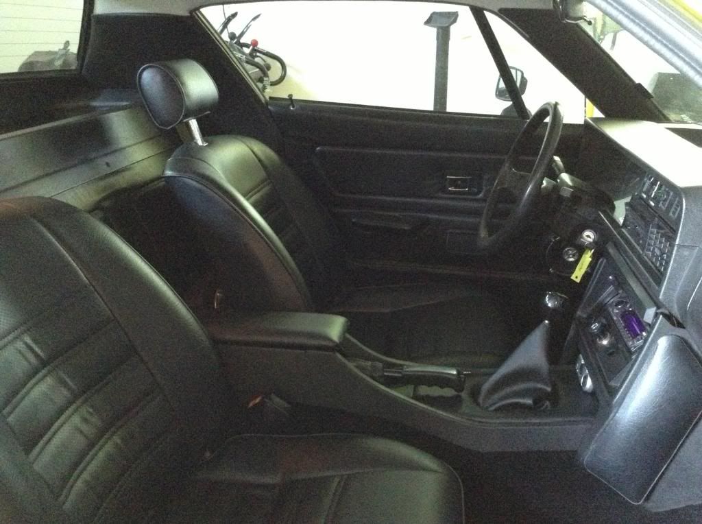

I'm not sold on the idea of adapting seats for the TR7. I had tried fitting some MR2 seats, again too tall. I had my original seats rebuilt and am very pleased with the comfort and appearance. The added "owner's touch" can also be incorporated when renewing your old seats.

Fastman- Are those off the shelf door cards??
