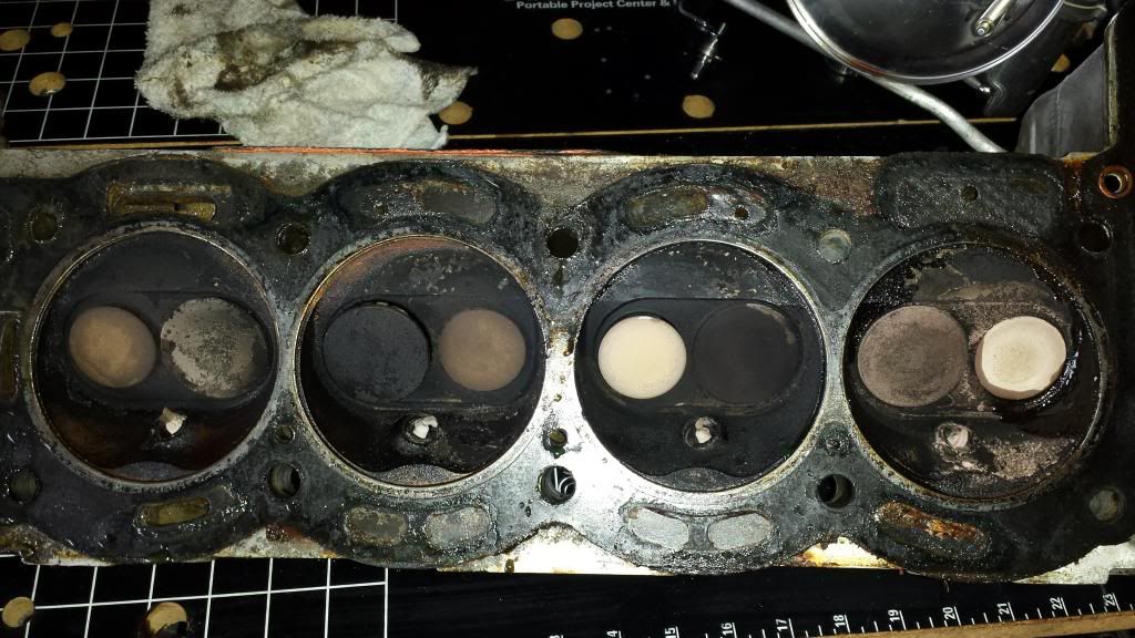

So I am debating weather or not to have my head rebuilt. I think I am going to have it skimmed. It doesn't appear to be warped but one of the walls between 2 cylinders seems a tiny bit high.
<b>So how do I determine if I should bother with replacing or resurfacing the valves and seats or guides?</b> Would it at least behoove me to replace the guides?
I'd certainly like knowing that it's done but I don't want to be wasting money where I don't have to.

I presume you are going to at least lap the valves. What the seats & valve faces look like should tell you if you need to cut or replace the seats.
How deeply the valves sit in the seats will give you an indication, but this is mostly about performance rather than reliability. The deeper the valve sits the less gas gets in & the lower the power.
The valves depend on how thin they are at the edge of the seating face. If they get very thin they will then get hotter, which leads to failure.
Once you have cleaned everything up you should be able to feel if there is much slop in the guides when the valve is open about 3/8". It is a road car, not a F1, so a little is OK.
To test how good things are after lapping, set the head up flat, with the valves just sitting in the head, no springs, & fill the combustion chambers with petrol. If more than just a little leaks out in a minute, it's not good enough.
Check the cam followers are not too worn. They wear at the top & bottom, giving a barrel shape. Replace if too sloppy.
