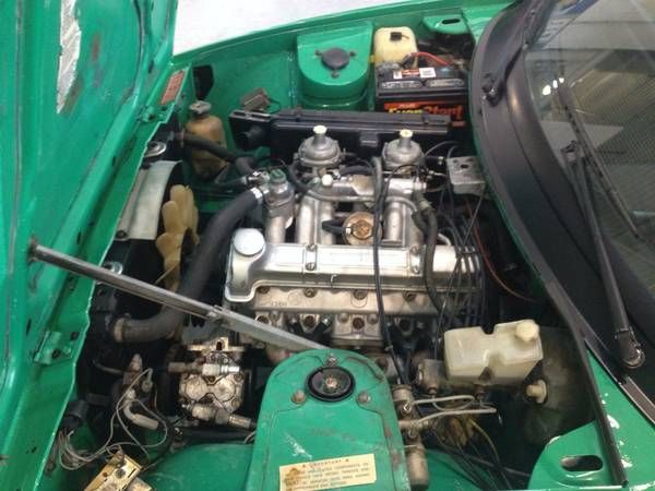

Here are a few pics of the car (sorry so big!). Interior and engine pics are the ones the seller used. Will takes some pics of the leak when time/weather permits.

Okay, here we go. In the engine photo, we are missing the sheet metal over the exhaust manifold that directs heated air thru the likewise missing hot air hose to the air cleaner spigot. This, in the current cold as all stuffing, winter weather will make starting the car difficult. I hope you realize the car has a manual choke, don't you? It appears from this angle you are missing the clips that attach the choke cables to the carburetors. Without these the engine will not start on a cold morning.
You are also missing the air pump and plumbing. This is not a bad thing and has no effect of tuning. As your car is over a certain age, this should have no effect on passing your areas annual state inspection.
I think I see the thermostat housing still has the plastic filler plug. If so, get rid of it and install the brass plug from a TR6, if you can find one, or the later aluminium plug from a post 1977 TR7.
Please note, the filler plug is used for initial fill purposes. Additional coolant can be filled in the plastic overflow bottle.
The TR7 has a myriad of hoses. Remove the air cleaner assembly and start the engine to find the coolant leakage. Report back with photos with your findings.
