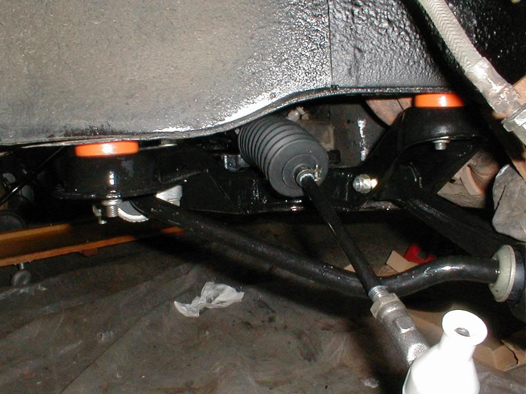

Taking the subframe off is quite easy without the need to use the bar you have made
Image[/URL]
I used 4 axle stands under the chassis rails allowing enough space to drop the subframe.
Using a trolley jack with block of wood - place it under the sump pan support at the rear of the engine leaving enough room to get to the engine mount on the subframe.
Removing each strut individually as you have done is best then , hang up the steering rack attached to the steering column.
Also found it easier to remove the anti -roll at & links for the control arms too. Then just drop the subframe by supporting to another trolley jack & pull out when the bolts are removed.
Keep the spacers & washers for each subframe separate ie take a photo of each as they come off as the front are different to the back ones.
It can be done in a single garage as per picture.
