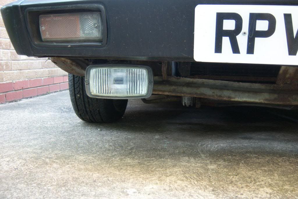

Not yet investigated and wiring but I have just removed these lights from the front of my car and they appear to have factory brackets fitted to existing holes.Still repairing extensive rust so will be a while before they go back on.
Steve..

I've often wondered how the fog light brackets fitted, it seems obvious when you see them in situ! A very secure fitting indeed. supercass
