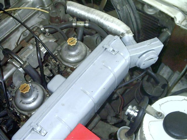

That said, for those ever optimistic souls installing NEW carburetor mounts that WILL split apart, please do the smart thing by installing two large hose clamps around the manifold and that sheet metal crossbar. This will provide strength to the mounts keeping them from having to support the weight of the carburetors and air box. Some folks hereabouts have used nylon ties but these are a bit weak in the muscle department compared with the metal hose clamps.
Here is a photo showing the clamps installed.
The very last thing I need on a cold, rainy night are for the carburetors to fall off. I might then have to use some most unfeminine technical language to express my opinion.
