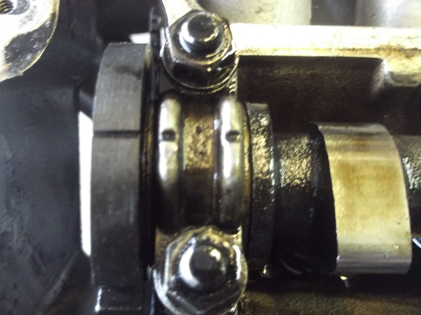

So if you have the cam shaft timing mark lined up ( as shown below ) the crankshaft pulley does not line with TDC [?] then your cam timing is out.
You need to correct this first before anything else.

when i happened to notice on the haynes book of lies that the write up said align the valve timing marks up with the retaining cap lines on the top end,
i didnt remember any line,mine was a thick notch,having never done this before i took the first line that came around,
rechecked on johns picture that he kindly sent me,(thanks john)and sure enough before the line shown on johns timing picture,there was the notch i had used to time mine with,
lined up the correct marks this time,surprise surprise,the pulley was bang on TDC..0..
