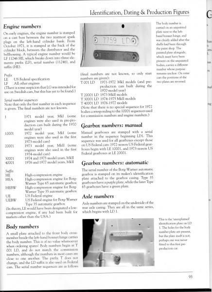

Postby Beans » 09 Jan 2012 19:58
If you are referring to one of these ...
That indeed is the body number.
I have found these on Canley and Solihull cars.

Postby Neil_W » 19 Jun 2015 06:44
Since I have moved onto a Stag but still pop into the TR7 Forum - thought this would interest folks from the 'other side'
Scan not too clear but screw your eyes up & zoom in to read the data :D
