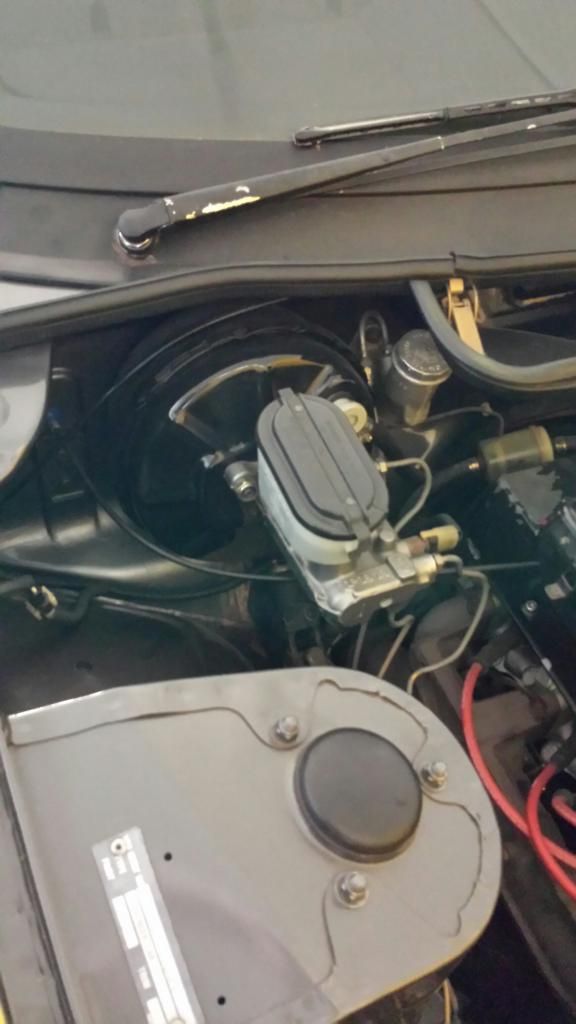

Hi Scott,
Fitting the VS V8 unit was actually one of the few jobs on my car not done by myself but by a brakes specialist. If memory serves me correctly (this was done about fifteen years ago) it was a straight fit which was why he selected that unit.
The unit from another angle:

Ok,
The perils of not doing the work yourself and believing that person:
At Mildred's request I spent a couple of hours researching the master cylinder part number. Only to find it is NOT from a VS Commodore...
It is in fact a PBR 15/16" unit from a VB-VK Commodore (1978-86) and is part PBR part no P10220.
Stay tuned for an update on the servo.

Postby Craig C » 07 Sep 2014 22:53
The brake servo (booster) would appear to be a PBR VH512 model. This is a steel double diaphragm unit from a VK-VR Commodore.
